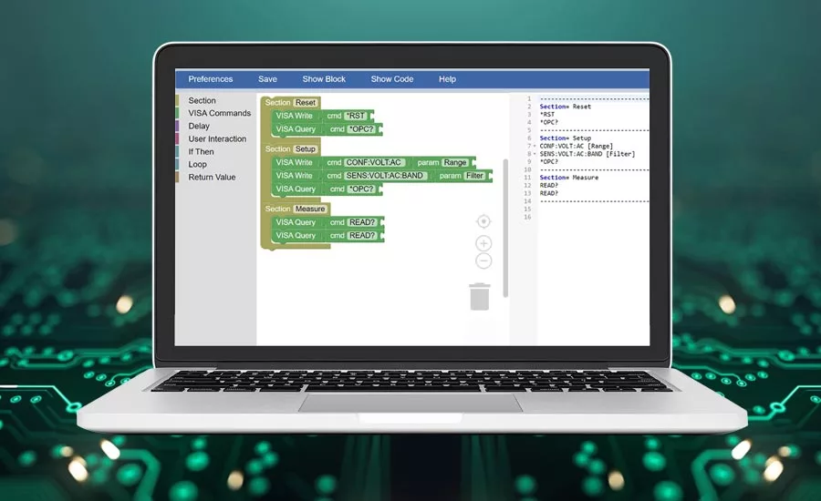

The last element in our model is the control script for the UUT using VISA Commands. Here we are showing an example of metrology bocks, a modified version of Google Blocks customized specifically for instrument control. As seen in Figure 4, the user is able to organize the block on the left-hand side of the screen while the code is generated on the right side.
AC Voltage commands
Figure 4: AC Voltage commands for a 34461A.
In Figure 4, you can see that there are only three sections: “Reset”, “Setup”, and “Measure”. This is because the “TestProccess.Source.Voltage.AC.Sinewave'' only needs those three calls to the UUT’s control script.
