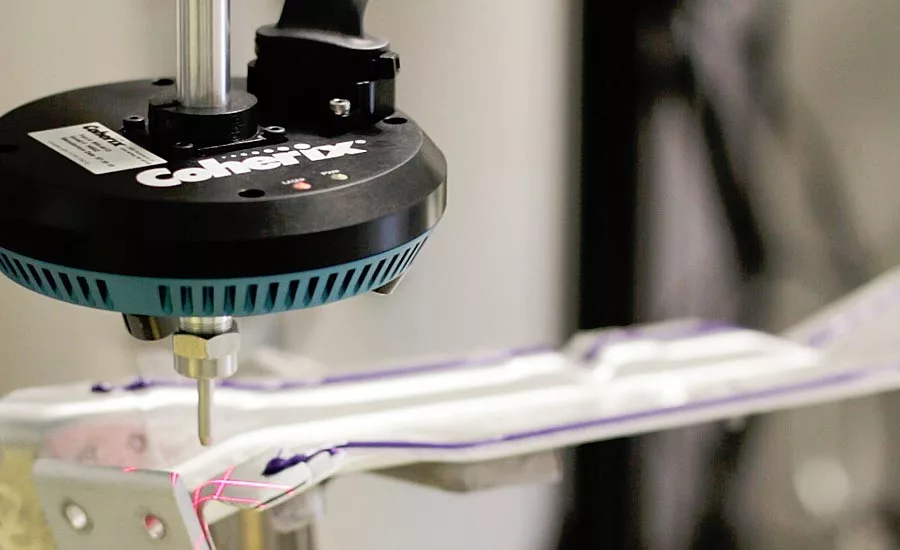

Utilizing a 3D inspection method provides vital information on the bead such as volume and location on part, it also saves productivity of the operators’ time.

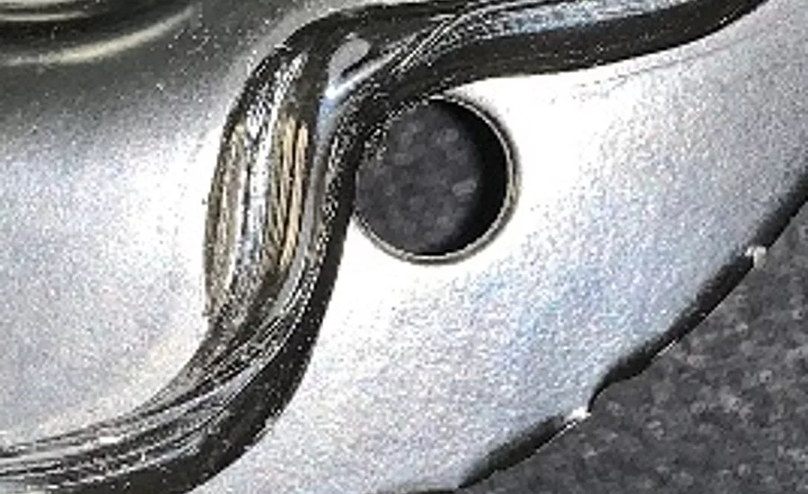

This adhesive bead was dispensed in the incorrect location, which could cause corrosion, water leakage, etc.

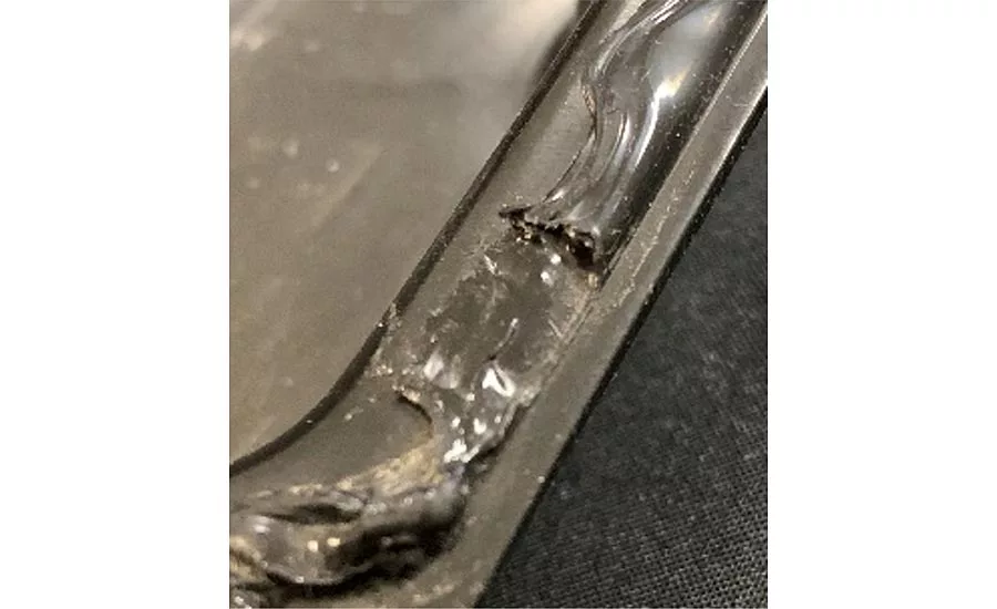

This adhesive bead has a large skip in the specified path and must be repaired.

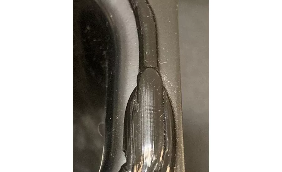

Too much adhesive or sealant can cause squeeze out, dispense material waste, contamination of downstream processes, etc.

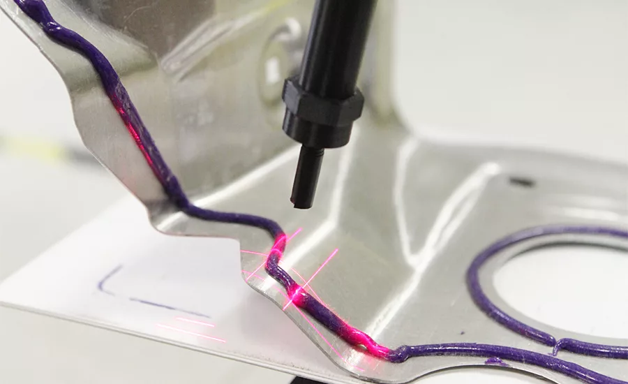

3D bead inspection is not affected by ambient lighting changes in the production environment.

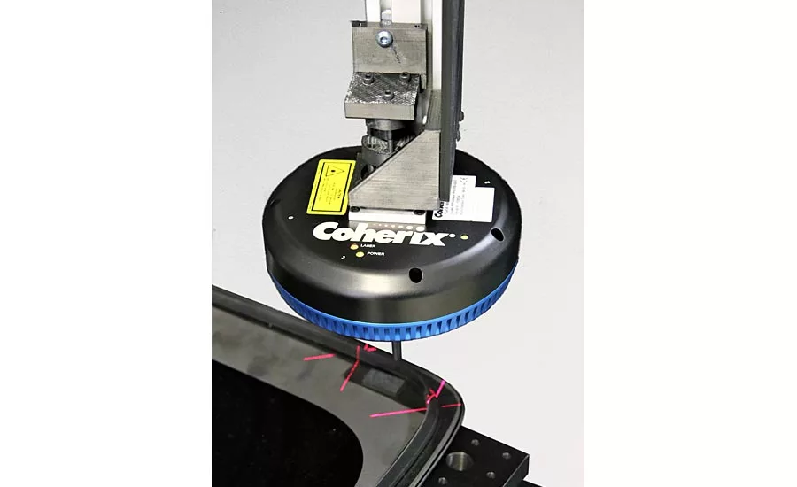

Inspection of high-profile glass urethane bead is critical to avoiding leaks and assuring structural rigidity in automotive manufacturing.
