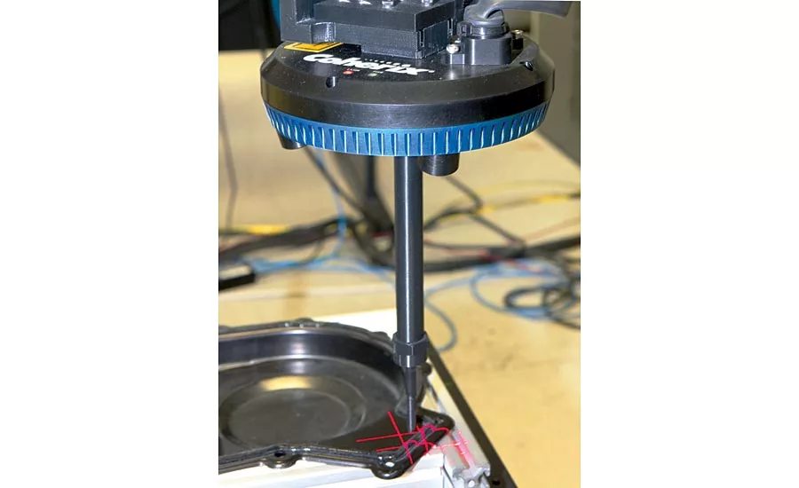

3D inline bead inspection technology.
The 3D inline bead inspection technology enables a possible industry paradigm change.
With the limitations mentioned above, 3D is the trend the industry is leaning toward for inline bead inspection. There is a big variety of 3D sensing technologies such as laser triangulation, stereovision, structured lighting, time-of-flight, laser interferometry, etc. Given the inline high-speed continuous imaging requirement, laser triangulation is the technology suitable for bead dispensing application. However, the general-purpose single laser line sensor is not sufficient because of the arbitrary dispensing direction and limited space around the dispensing nozzle. One option is to implement a motorized single laser line to trail the arbitrary dispensing direction. However, the modern dispensing process can reach 400mm/s to 1,000mm/s for high productivity. With this high speed, it is very difficult to have the motor respond quickly and reliably enough to any sharp dispensing direction change. The other option is the 3D inline bead inspection system with multiple laser lines stationary around the nozzle. This sensor design ensures inspection of the bead with no blind corner for any arbitrary dispensing direction.
The 3D inline bead inspection technology enables a possible industry paradigm change. With this instantaneous 3D visualization and inspection capability on the bead, product development is empowered to specify the bead in a manner which is directly related to its functionality; and manufacturing engineering is empowered to better control and optimize the expensive dispensing processes.
