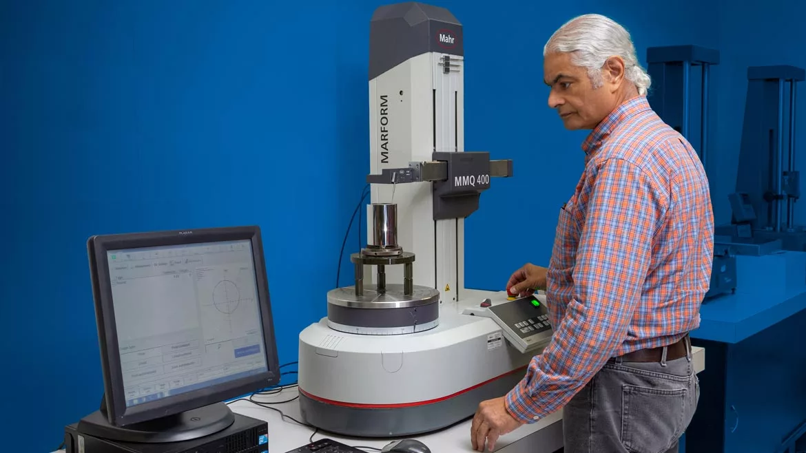

QM 1221 Test & Inspection: MMQ-400 2804 Clip color
This roundness/cylindricity measuring system can measure a multitude of form characteristics and requires that each moving axis of the system be calibrated and the relationship (parallelism or perpendicularity) between them be checked. Image Source: Mahr

In the roundness testing example, the OEM’s field technician will begin by testing all the various functionalities of that machine such as the straightness of every axis, roundness of the rotating axis, etc. Next, they will perform an internal cleaning of the machine, lubrications where needed, change any parts that are showing wear and tear, tighten up any loose belts, etc.
