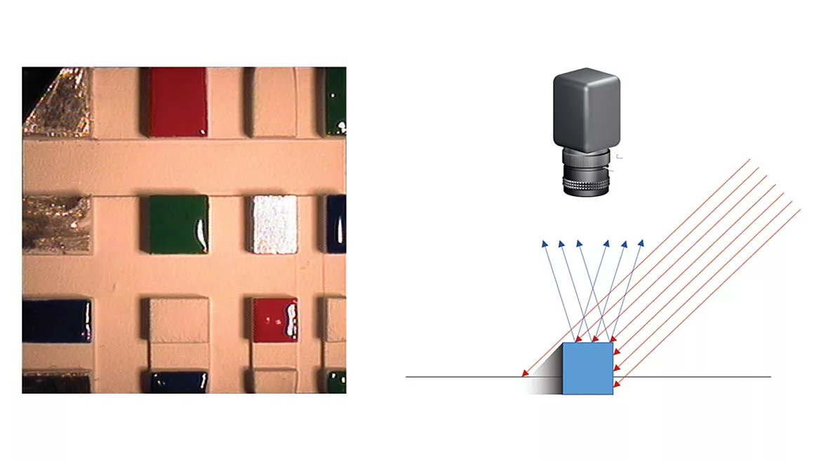

Table 2: Common Types of Illumination Recommendations for an Imaging System
VS 0522 Machine Vision 101 Table 2-A directional
Table 2A directional

The last important and major set of characteristics for an imaging system is related to the illumination. If the environment is too dark, a clear image is nearly impossible. Many fixed focal length lenses have adjustable apertures. The f-number (f/#) is a value that describes the size of the aperture stop, which is the point along the optical axis and within the lens stack, where the cross-sectional area that light passes through is the smallest. A larger f/# is associated with an increase in aperture closure and less light entering. External apertures can also be used to control light throughput if a lens does not have an internal aperture. Machine vision filters may be used to reject or pass certain wavelengths or wavebands into or out of the imaging system. Polarizers can also be used to pass or reject specific polarizations of light to eliminate glare for clearer pictures. Figure 4 shows the difference between images with polarized and non-polarized light.

There are multiple types of illumination that can be accomplished with different sources. LEDs offer long lifetimes, are available in a variety of colors, and can be intensity controlled for specific configuration of many illumination schemes. Fiber optic illumination typically uses light guides to direct light into specific space-constrained applications. Light guides are used for in-line illumination, which is integrated into many telecentric lens designs. In-line illumination enables brightfield illumination over the entire FOV. Figure 5 shows the difference between using a telecentric lens with a ring light versus in-line illumination. The image shows a divergence of the beam path between both types of illumination. By determining the ideal type of illumination for the application, blurriness is minimized and image quality is improved. Table 2 defines different types of illumination and shows how the illumination is used. The object surface and surrounding environment help determine what type of illumination is needed for the application requirements.
