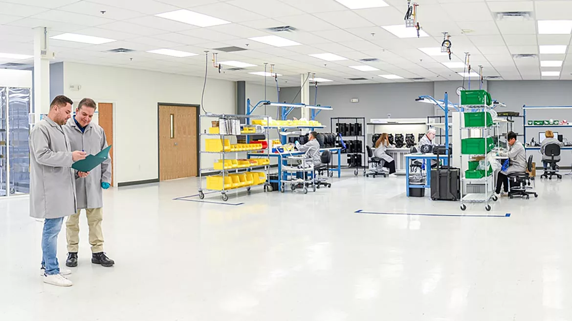

Manufacturing at Optikos employs lean process improvement practices for inspection through assembly and delivery. Within each cell at Optikos are multiple work stations each addressing an assembly procedure based on lean manufacturing concepts. Each cell has been created for assemblers to move seamlessly between cells, and every work station includes detailed customized work instructions, tooling, fixturing and any inspection tools that might be required for that particular procedure. Using just in time concepts for kitting the assemblies for each cell eliminates overproduction and extra processing. Inventory specialists closely monitor each cell to manage the inventory for each cell accordingly so that only necessary product is on the floor, eliminating unused inventory on the assembly floor. By systematically identifying the optimal control of the Optikos product lines, the processes and cells have been successfully designed to be scaled for growth.
