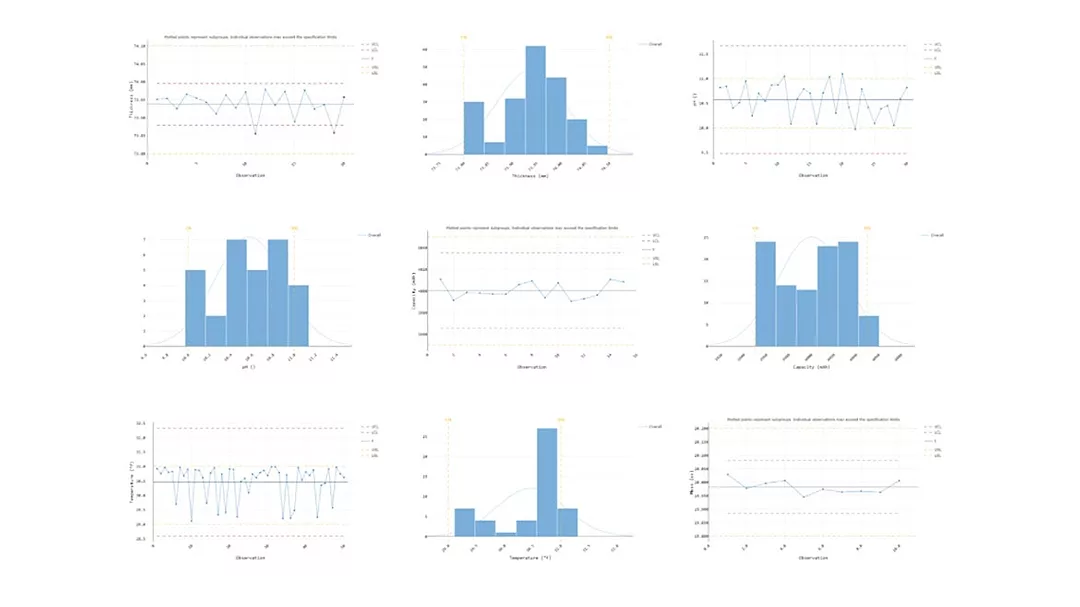

Statistical process control (SPC) software has become an indispensable tool for quality managers. It provides a comprehensive view of the production process, enabling managers to detect any deviations from the standard process and take corrective actions to ensure that the final product meets the desired specifications.
The future of SPC software looks promising, says Tamela Serensits, founder/CEO, Argolytics LLC, as advancements in technology are making SPC software more user-friendly and accessible. New features such as machine learning and predictive analytics are being added to SPC software, making it even more indispensable to an organization.
Q-cast logo
The Future of SPC Software
Tamela Serensits, founder/CEO of Argolytics, describes potential SPC hurdles, how SPC software can benefit manufacturers of all sizes, and how to embrace new technology.
Such software helps answer key questions about process capability and stability. By automating the calculation process, SPC software helps practitioners perform SPC accurately and in real time.
SPC software provides a range of benefits for quality managers, including:

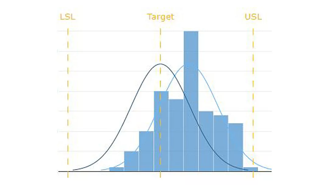

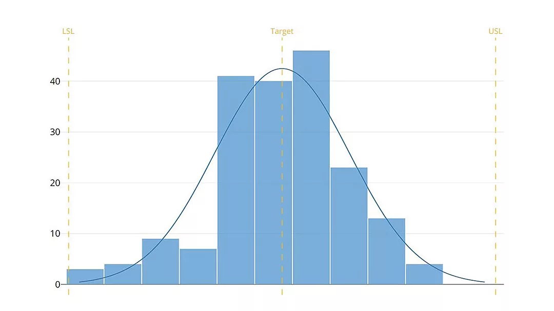

  • Plotting histograms and calculating process capability indices to evaluate the normality of processes and determine their capability;

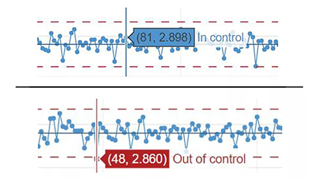

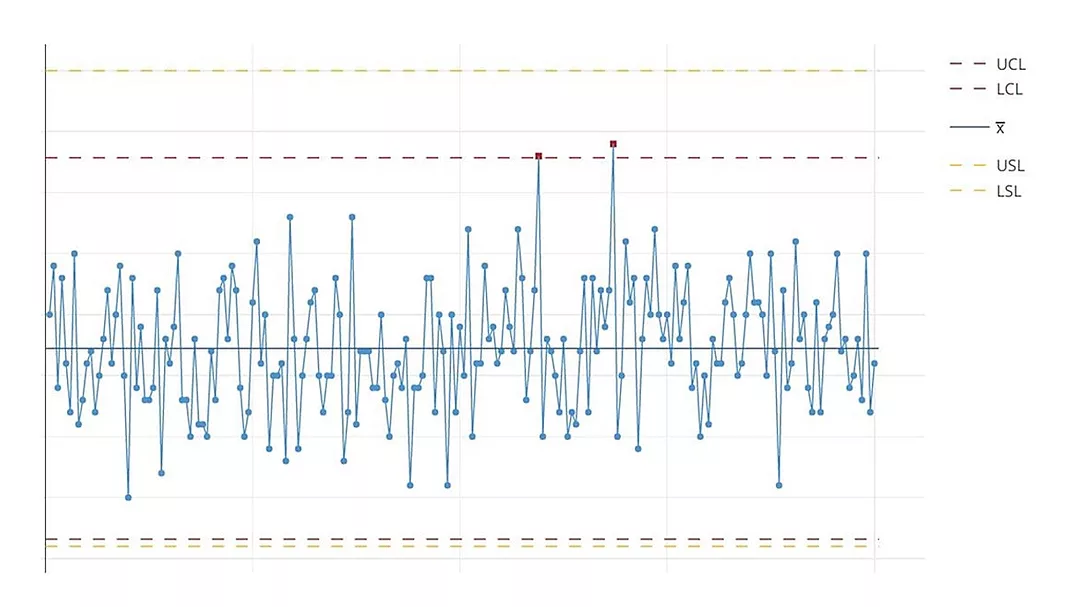

  • Plotting control charts to evaluate the stability of processes as they run and provide early warnings of drifts and variation changes;
  • Performing stratified analysis on processes to compare process runs and determine potential cause and effect relationships; and
  • Providing digital dashboards and alarms to enable managers to manage by exception.
