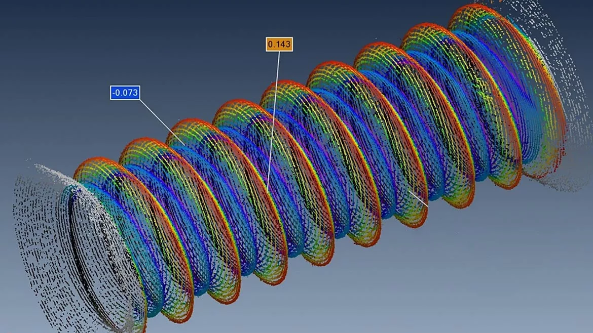

The other measurement tool we will discuss is based upon the use of white light interferometry. Interferometry has been around for over 150 years as a means to measure optical elements that are made to millionth of an inch (nanometer) surface figures. These precision shapes allow us to make lab instruments like microscopes but also big telescopes like the James Webb Space Telescope recently launched. Some 25 years ago, a group of researchers at MIT used the effect that white light (non-laser or one color) will create an interference pattern over only a very shallow range on the micron to submicron scale.[3] Over time, similar tools as described above using mechanical scanning and spectral effects have led to the benchtop white light interferometers often seen in precision manufacturing shops today as a standard for measuring surface finish or fine features like surface defects. A similar scanning mechanism is typically used in these instruments but now using the presence of an interference pattern of “blinking light” to identify specific locations at a given depth rather than focus clarity. More recently, these tools have been extended to point measurement sensors that can provide very fast sub tenth of a mil (sub-micron) level measurements at kilohertz rates. [4]
05 QM 0823 FEAT MeasureB Fig4 diagram
Figure 4. A white light interferometer uses various means to scan the “interference point or point” through range, looking for where the interference pattern causes an oscillation of the light to indicate a measurement, for example the inner thread of a nut. Photo courtesy of Novacam Technologies Inc.
The white light interferometer sensor can have inches (centimeters) of range without the need for a large collection angle of light. Systems using mirrors and rotating scanners have been effective at measuring small, deep bore holes and cavities looking through limited size access ports. The light still needs to reflect back to the sensor, and it cannot be “scrambled” such as the light piping seen in a plastic or translucent part. But otherwise, the white light probe can provide a robust measurement at very fine dimensions.
