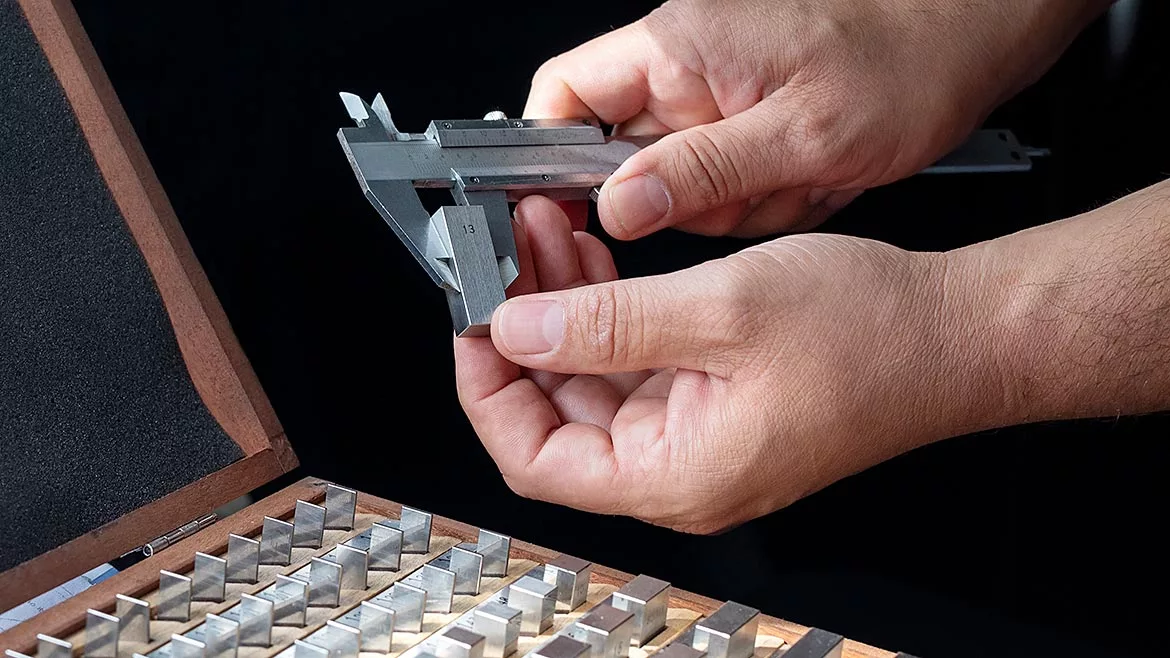

Calibration is a fundamental process that ensures accuracy and reliability in measurement. It is the process of comparing the measurement values obtained from a device or instrument to the standard values to determine the accuracy of the device. In this article, we will discuss the basics of calibration, its importance, the different methods used for calibration, and the latest developments.
Part 1: What Is Meant By Calibration?
Calibration is the process of comparing a measurement device or system's accuracy to a standard. The goal of calibration is to ensure that the device or system provides accurate and reliable measurements. Calibration is a critical aspect of many industries, including manufacturing, healthcare, and environmental monitoring. The accuracy of measurement devices is essential in ensuring that products meet quality standards, the equipment operates efficiently, and regulatory compliance is maintained.
