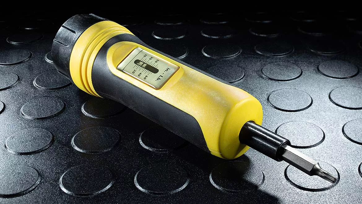

One approach is establishing calibration intervals [1] based on equipment usage and failure history. Example, you have a fixed torque screwdriver system in your final assembly run and you know that after 1,800 hours of usage you expect failures. History shows that slippage or other issues occur after 1,000 hours of usage. The torque screwdriver has a recommended calibration interval of 12 months, but 1,000 hours is less than six months on your production line. This is where evaluation of the equipment usage and failure history could prevent unnecessary risk of OOT conditions. Shortening the calibration interval to less than 1,000 hours on each torque screwdriver would reduce risk of nonconforming product being released and would also potentially show equipment that is needing maintenance or nearing end of cost-effective life.
