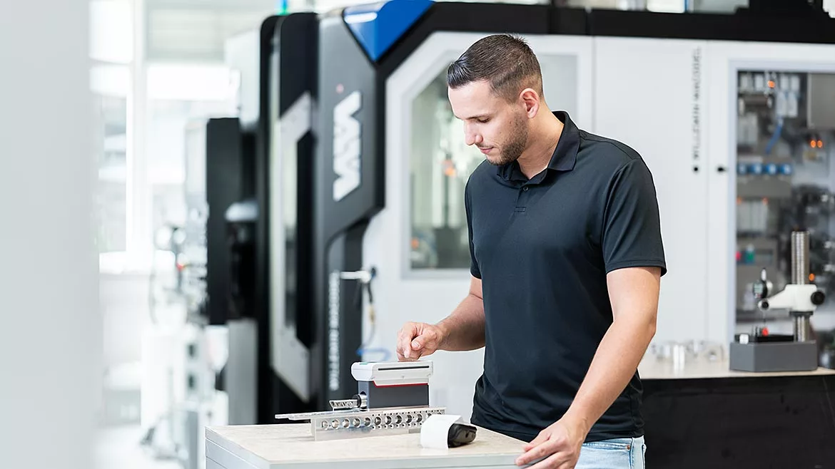

Operating using MarSurf M 410

MarSurf M-410 interface used by an operator
With a user interface similar to a smartphone, complex high-performance tools are easy to use for the operator – increasing acceptance and implementation.Images Source: Mahr
