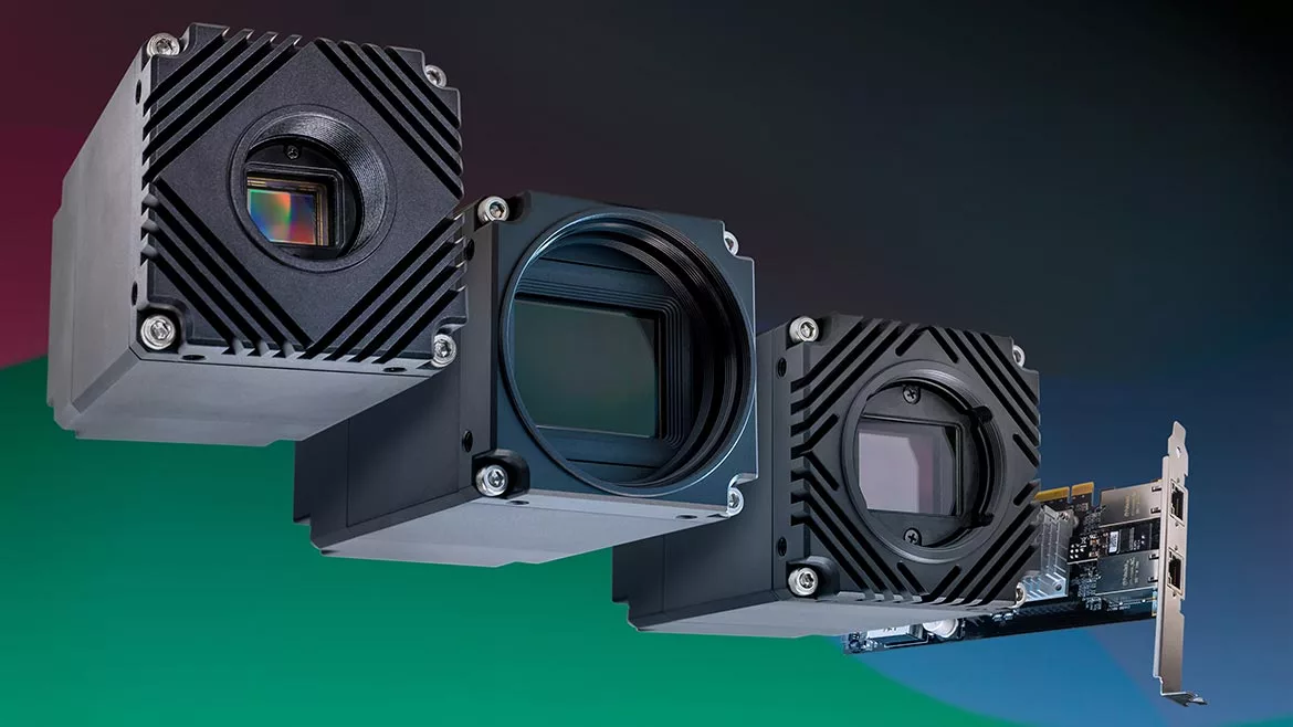

Vision & Sensors Cameras feature: Cameras Motherboard with RDMA card Atlas10
The Host Channel Adapter (HCA) manages RoCE operations, implementing in hardware all the logic needed to execute RDMA protocol. Data segmentation and reassembly as well as flow control are managed by the HCA allowing the sender and receiver applications to work with whole buffers. The RDMA channel is initiated by “pinning” host PC memory. A memory region is reserved on the host for RDMA usage, the necessary protections are applied, and then the host passes the address to the HCA and removes itself from the data path. This registered memory region can now be used for any RDMA operation.
