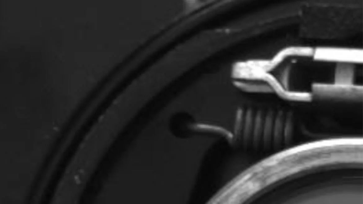

Early stages of image analysis may involve filters and similar tools which transform the entire image to enable or optimize the later stages. One of the simplest of these is a lookup table tool which creates an output value for each pixel based only on its input value (a distinction from a filter where the output value of each pixel is also influenced by its neighbors). This is most commonly used to increase contrast in one area of the gray scale. In figure 1 a “square root” lookup table is applied to the shown portion of a brake assembly in the upper half of the figure to provide greater contrast to the features in the dark areas shown in the lower half. The math of this transformation is illustrated in figure 2. The horizontal axis represents in input gray scale level and the vertical axis represents the transformed output value for that pixel. For 8-bit gray scale, the maximum for each axis must be 255, pure white. The green drawn “x=y” straight line graph would represent “no change”, and the blue curve represents the change applied.
