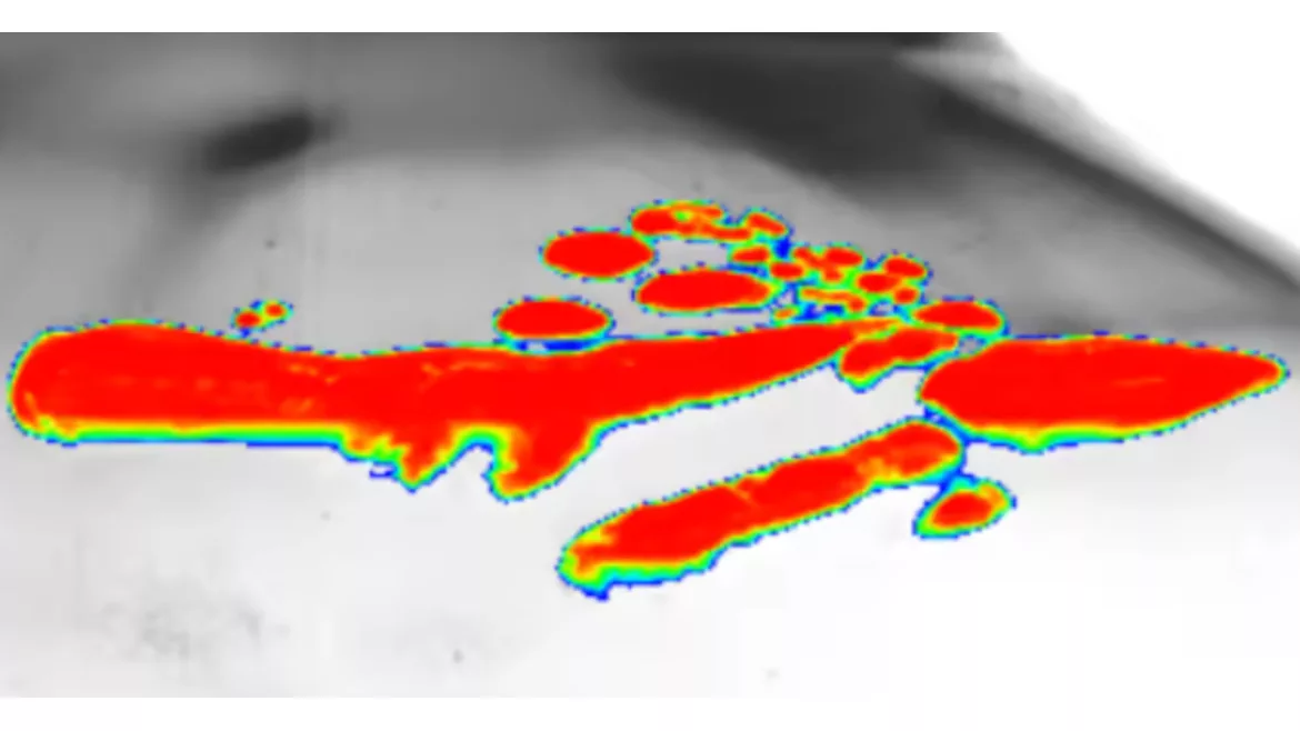

VS 0522 Trends Deep Learning Figure 2
Figure 2 Source: FSI Technologies
Figure 2 shows one of the available displays of the results, a “heat map” which shades the areas that the model considers defective. Note that it successfully identified the defective areas and was able to ignore the large quantity and diversity of dark areas that are not defects.
The main advantage for deep learning is a huge one: it enables accomplishing inspections that were impossible, unfeasible or comparatively more difficult using traditional machine vision. We used a common “differentiation” example. A few other areas where it excels are decisions involving multiple weighted variables, or spotting commonalities in patterns such as in difficult OCR applications. Now let’s look at the disadvantages.
