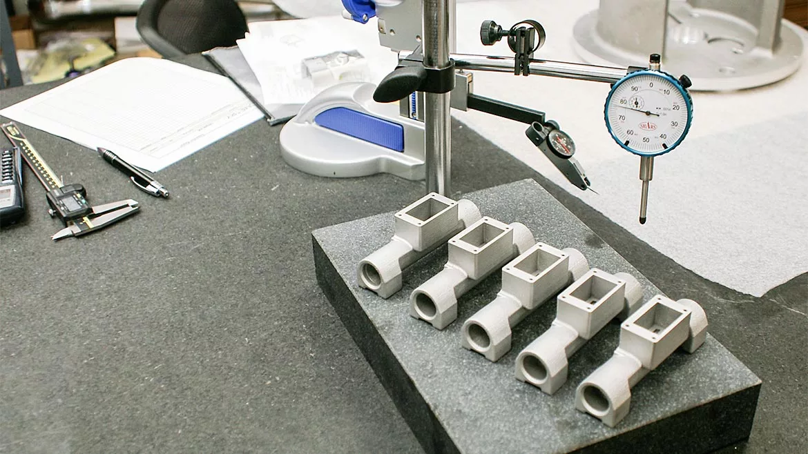

Measurement and Inspection of Additive Manufactured Components
As-built 3D prints should have standard inspections applied after they are cleaned, and supports are removed. This includes general size measurements to ensure proper scale (e.g., XYZ) and that all features are resolved to the extent of the equipment and material selected. Technical drawings should only highlight what is critical for the part function and must be considerate of the processes’ general manufacturing standards. This may affect general tolerances on the title block. For cases like rapid prototyping, this general inspection is usually sufficient for shipping.
Once the near-net shape has passed preliminary inspection, the secondary processes can be applied, and a separate print may dictate the final product’s needs. It is important to understand that any features in contact with sacrificial supporting structures or, in some instances, the build plate may need looser tolerance requirements than other grown features. This helps accommodate for surface deviations after part and support removal.
Parts can be inspected with manual tools, gages, vision systems, or CMM. One major difference in inspecting additive manufactured components is how cantilevered features, such as on a manifold, should be toleranced. Minor deflections from printing and secondary processes can affect these features and may require their datums for machining. Internal structures are difficult to measure with manual tools or gages and nondestructive methods like CT scanning become useful.
In metal production cases, tensile bars and other accompanying pieces are printed simultaneously for testing and inspection of material properties without directly testing the printed component. These test items are printed with every new part to ensure consistent passable results for mechanical validation.
