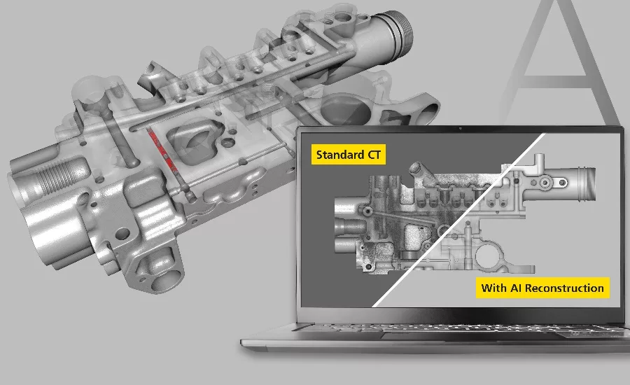

Nikon IMBU has released AI Reconstruction, a 3D computed tomography (CT) reconstruction software solution powered by artificial intelligence that lifts the traditional trade-off between scan speed and image quality.
By applying Deep Learning techniques to enhance image quality, Nikon’s breakthrough technology enables rapid results and superior analysis. Traditionally, CT users have had to pick between fast, lower-quality scans or slow, higher-quality scans. If scans are quick, important details can be missed. If scans are slow, fewer items can be scanned.
AI Reconstruction lifts these limits through AI enhancement tailored to individual customer needs by Nikon’s Applications Engineering team. The Deep Learning modeling underpinning AI Reconstruction is trained to distinguish relevant information from the scan artifacts to effectively filter noise and improve clarity.
Examples of where this technology will demonstrate a profound impact include the automotive, aerospace and manufacturing sectors, as well as the medical device industry. In these sectors and others, meticulous quality control via precise metrology is essential for product safety.
Through rigorous trials, Nikon’s breakthrough technology has been validated to provide dependable performance. It offers flexible integration with leading analysis packages for reliable inspection of the most challenging component geometries.
