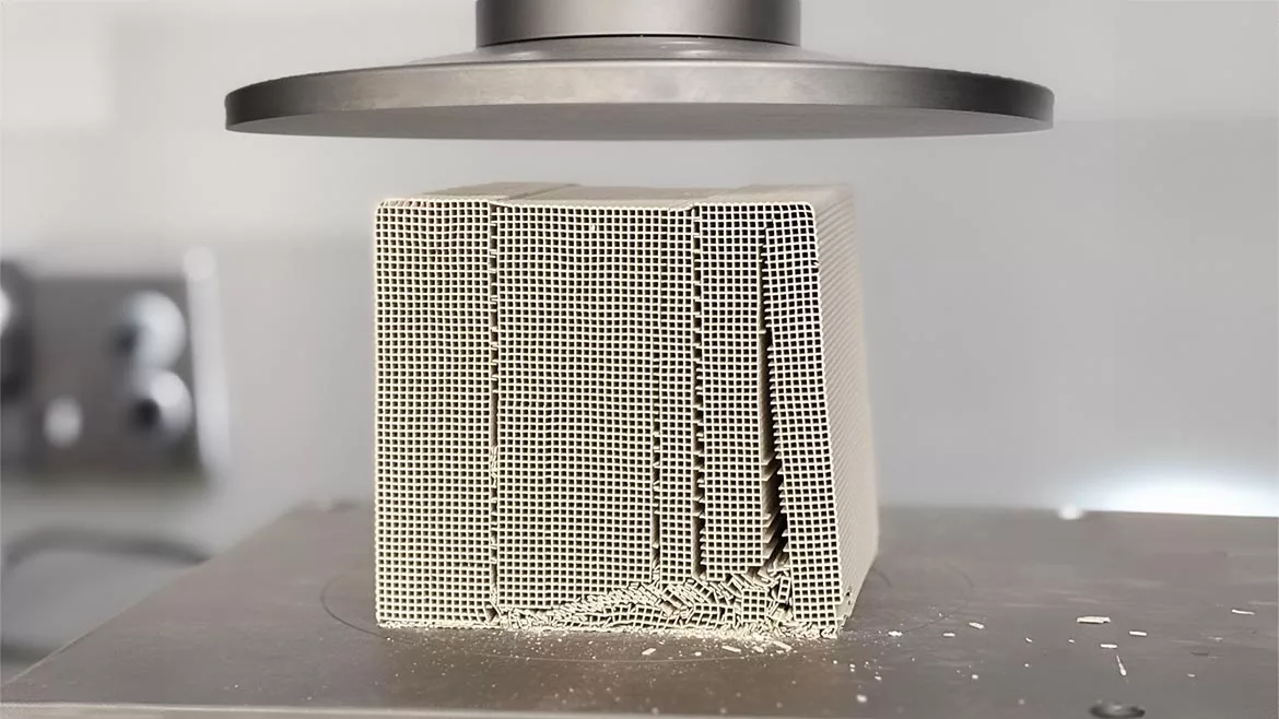

To maintain the structural integrity and operational efficiency of their zeolite monoliths, TerraFixing relies on the Mecmesin OmniTest 25 universal testing machine. This versatile instrument plays a pivotal role in testing the mechanical properties critical to the DAC process.
Testing objectives: The OmniTest 25 evaluates two key parameters:
  • Cold Crushing Strength (CCS): Ensuring monoliths can endure mechanical stress during operation.
  • Modulus of Rupture (MOR): Assessing the structural robustness under applied loads.
All testing is conducted in compliance with ASTM C133-97 standards, ensuring the materials meet stringent quality and durability benchmarks.

  • Monolith preparation: Zeolite monoliths are meticulously prepared for testing.
  • Mechanical testing: Using the OmniTest 25, the crushing strength and durability of the monoliths are evaluated.
  • Data collection and analysis: VectorPro software captures critical performance data, facilitating real-time monitoring and detailed reporting. This enables TerraFixing to continually refine their materials and manufacturing processes.
Quality assurance: Approximately 20 monoliths are produced and tested monthly, ensuring each meets rigorous quality standards before deployment.
