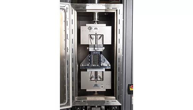

This is a 250 kN electromechanical system with chambers and hydraulic grips.

Examples of common standards for the tensile testing of laminates are ASTM D 3039, EN 2561, EN 2597, ISO 527-4, and ISO 527-5. The specimens are parallel sided with bonded tabs to prevent the grip jaws from damaging the material and causing premature failures. Gripping mechanisms include manual and hydraulic wedge grips. For demanding aerospace testing, hydraulic wedge gripping solutions are generally preferred because of their controllability and repeatability. However, well-designed mechanical wedge grips can also provide good levels of alignment. Hydraulic grip solutions for non-ambient testing often place the hydraulic components outside the temperature chamber for safety and reliability.
Accurate alignment of the grips and specimen is very important when testing composite materials due to the fact that the anisotropic properties, such as the modulus and strength, of the material differ depending on the direction of the applied stress and are often brittle in nature. Adjustable alignment fixtures are available to ensure that testing systems meet the alignment criteria required for reliable composites testing and as required by specific audit programs used by aerospace industries, such as Nadcap AC7122/1. To be effective, alignment fixtures need to allow adjustment of both concentricity and angularity while the machine load-string is under load. The accepted method of checking for alignment under load is to use a strain gaged “alignment cell or specimen.” The alignment cell should have dimensions that are as close to the specimens being tested as possible. Typically the alignment cell will be fitted with two or three groups of four strain gages. Additionally, software is available that will provide a display of both the bending and the concentricity and angularity errors. This software identifies the adjustments that are required and displays, in real time, the effect of the adjustments, enabling accurate machine set-up in minutes.
When using well-aligned grips, it is recommended that the grips are permanently left in place on the testing machine and that, when needed, test fixtures including compression platens and bend fixtures are mounted on the grips using adapters.

All compression fixtures are required to have good axial alignment and a high lateral stiffness in order to provide and maintain accurate alignment under the lateral loads that can be generated by a compression test. Bending will have a significant effect on test results and most of the compression test methods include a value for the maximum allowed specimen bending. Common composites compression test standards include: ASTM D695, ASTM D3410, ASTM D6641, ISO 14126, and prEN 2850.
