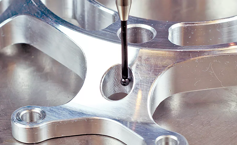

A 3 mm silicon nitride ball stylus probes a race car wheel center. Source: Q-Mark Manufacturing Inc.

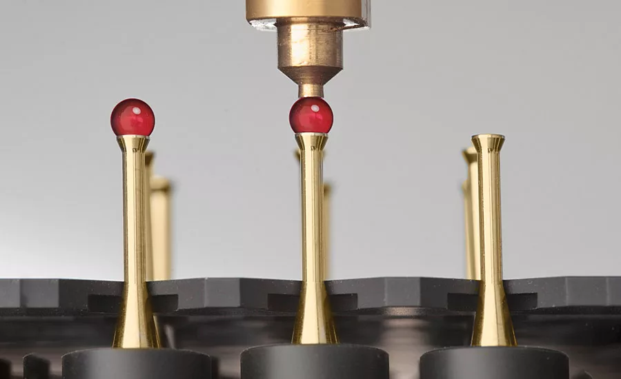

These Renishaw styli have ruby tips on titanium nitride stems. Source: Renishaw

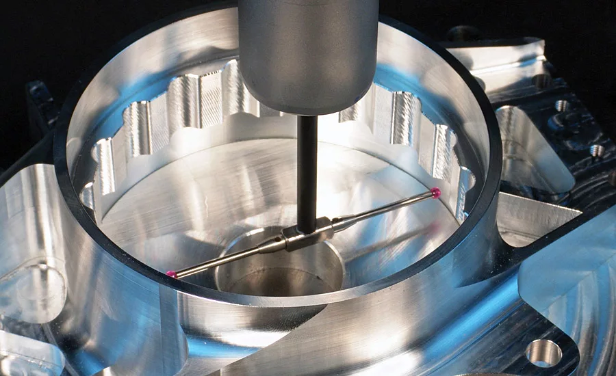

Opposing 3 mm ruby ball styli check an internal feature on a race car suspension part. Source: Q-Mark Manufacturing Inc.

A popular alternative to ruby for use with aluminum is silicon nitride.
“Silicon nitride has all the advantages of ruby, plus it does not suffer the build-up that ruby does,” Osterstock says. “The disadvantage is, it’s significantly more expensive than ruby, particularly because of the machining to put a hole into it (to connect to the stylus stem) is very difficult.”
