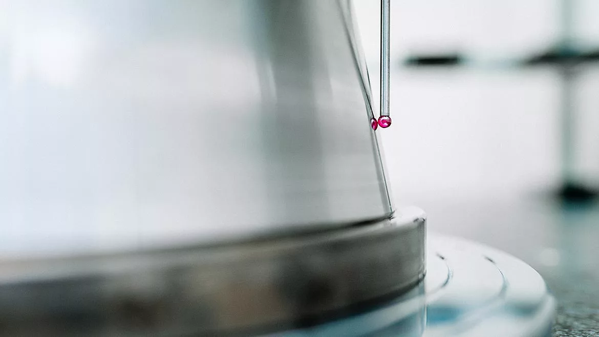

Reliable measuring results from coordinate measuring machines (CMMs) are critical to monitoring manufacturing processes and delivering high-quality parts. Absolute confidence in part quality can only be achieved by keeping the measuring uncertainty at a minimum.
Styli and probe extensions can provide that certainty for most measurements. However, deep boreholes and hard-to-access features present challenges.
Don’t sacrifice quality by using the wrong styli and probe extensions. Find the right tools made from the right materials for your quality needs.

Extensions have a direct influence on the measuring uncertainty of an overall metrology system. Consequently, the accuracy of what a CMM can achieve, according to specifications, will only worsen when using unsuitable extensions.
Extension performance can be challenged by three determining factors:
  • Weight: The lighter and more rigid the stylus extension, the faster the machine can measure without negatively impacting the precision of the system through bending or centrifugal forces.
  • Thermal expansion: Temperature fluctuations can cause significant CMM measurement errors. “The use of stylus extensions will reduce probe accuracy due to the loss of rigidity and susceptibility to temperature changes,” says the United Kingdom’s National Physical Laboratory.
  • Static rigidity: The rigidity of the entire stylus system is significantly influenced by the type and design of the extension. Even slight extensions can lead to considerable fluctuations in reproducibility. The type and design of connection points also have a significant influence on measuring accuracy.
Operators should also be aware of best practices when using extensions for both styli and probes. As the National Physical Laboratory explains, “Manufacturers of probe heads and accessories generally specify maximum recommended lengths for probe extensions. Using extensions that exceed these lengths may seriously affect the accuracy and repeatability of the probe head readings.”
