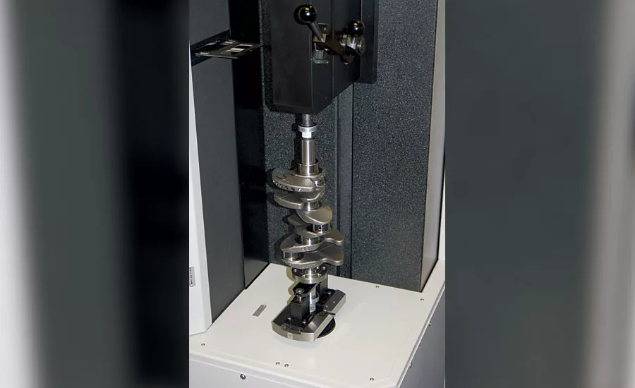

Crankshaft measurement
Jenoptik automatic crankshaft measurement systems are capable of measuring multiple part types randomly introduced on the fly, at production rates, with cycle times measured in seconds. This provides valuable data for process optimization. Source: Jenoptik

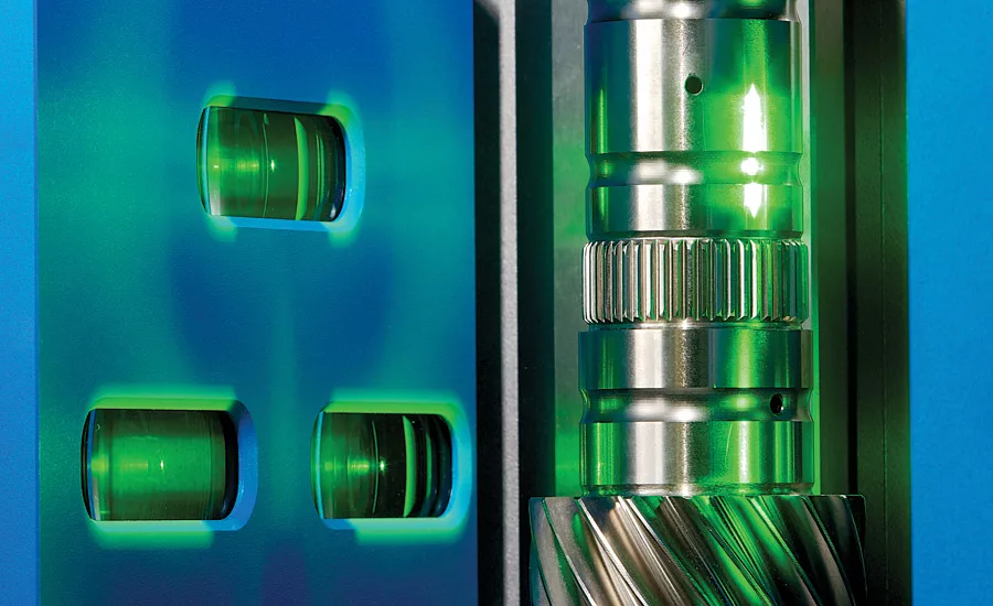

Optical Measurement
Noncontact optical systems can be benchtop, designed for operation on the shop floor, to large lab machines. The biggest advantages to optical technology is its flexibility and speed in evaluating almost any part type that will fit within the confines of system itself, as well as its ease of use when setting up these new part types. Source: Jenoptik

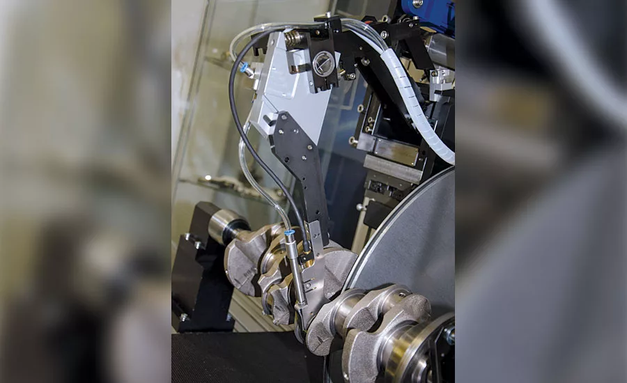

Quality measurement in process
In-process gaging for grinding operations, such as on this crankshaft, are dedicated systems for measuring form, geometry, and roughness. This automatic system is capable of measuring at full machine speed and provides data used to adjust the grinding process to assure consistent quality production.
Source: Jenoptik

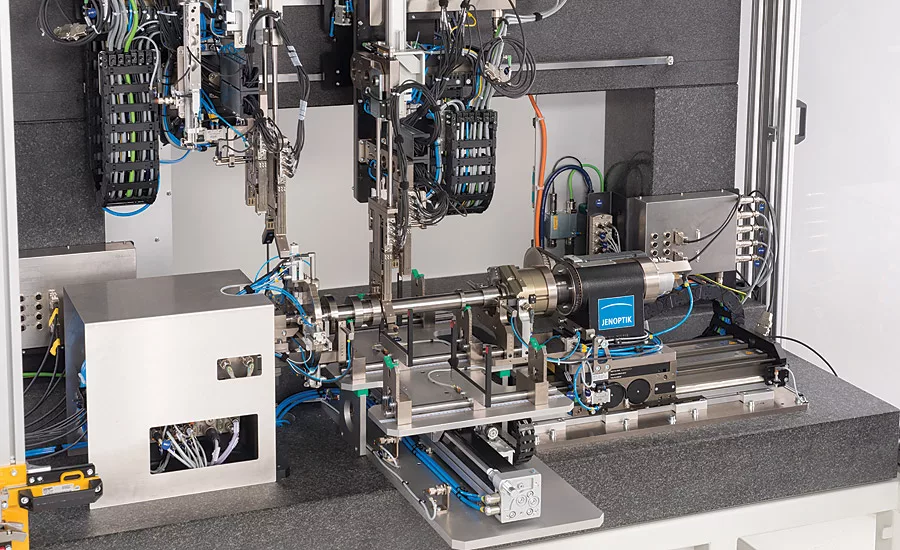

traceable measurement
A traceable crankshaft journal form measurement machine automatically measures a wide range of journal characteristics from form and pitch to diameter, parallelism, cylindricity and more. Source: Jenoptik
Optical Measurement

OPTICAL
The most recent technology to gain acceptance for shaft dimensional inspections are optical systems. The improving capability of optical measurement systems over the last few years has led to increasing popularity of this type of technology. Better lighting systems, high resolution sensors, and improved software has led to a marked increase in the overall capability of these systems to perform industry leading evaluations on a highly diverse group of parts.
The single biggest advantage to optical technology is its flexibility in evaluating almost any part type that will fit within the confines of the system itself, as well as its ease of use when setting up these new part types.
Simply load the part into the gage, perform a complete part scan with the system optics and then select locations on the scanned image for the evaluations you want to perform. Once all the evaluations have been assigned to the part, select start and the entire part can be inspected in a matter of a few seconds. Applications for optical gaging would exclusively consist of post-process systems, both in-line and off-line.
