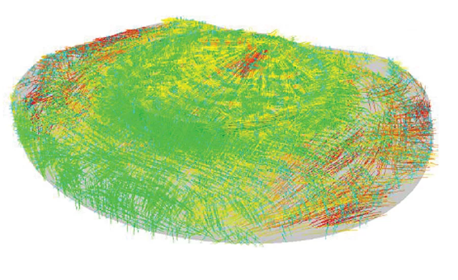

The challenge when designing implants that take advantage of reinforced plastics is in predicting the as-manufactured material performance. The mechanical properties of an implant designed with fiber reinforced plastics can vary widely depending on the use of the material and how the implant is manufactured. The injection molding process used to manufacture the implant will affect the fiber orientations throughout the part and the induced mechanical properties.
Typical analysis assumes the material is homogeneous and isotropic for simplicity. In reality, fiber alignments continuously change throughout the implant, resulting in a heterogeneous, anisotropic material. Wrongly aligned fibers or not appropriately accounting for the fibers’ effect on material performance can lead to a softer or stiffer implant than designed, and even premature, unpredictable failure.
SOLUTION
Medicrea solved the isotropic versus anisotropic problem by using MSC Software’s Digimat, a non-linear multi-scale material and structure modeling software platform, to create a micromechanical material simulation of the implant design. Unlike a homogeneous isotropic analysis, Digimat’s heterogeneous anisotropic analysis considers the variation in fiber content and alignments and how they affect material properties. Figure 1 depicts how a simulation model shows variations in fiber orientation throughout the plate of a spinal implant.

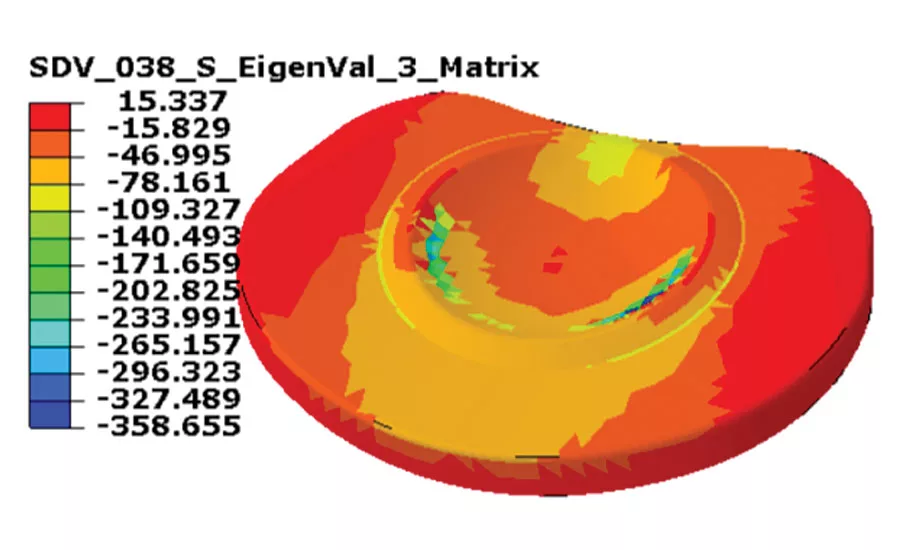

By selecting intelligent material models of the reinforced plastic from the software’s material library and creating models using integrated tools, Medicrea engineers mapped the fiber orientations, residual temperatures and residual stresses onto the structural analysis model. The intelligent material model is a function of fiber orientations instead of an approximate/guessed value, so it adjusts the material stiffness at every location throughout the implant.
With this preliminary work done, engineers were ready to conduct the usual analysis with one key exception: the approximate value for material stiffness will be replaced by the local material model. The simulation software takes care of tying the intelligent material into the analysis solution so that the analyst can focus on designing the implant’s performance, not guessing at which material property might give the best results. Figure 2 depicts the results of a simulation that incorporates material property data and fiber alignment into the analysis.

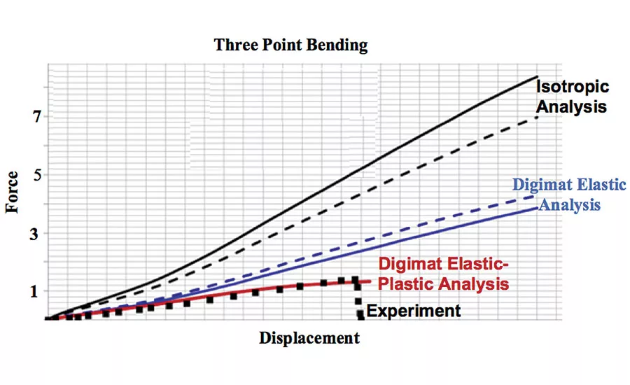

The attention to material details yields more accurate simulations that reduce test/analysis iterations and improve performance predictions. In the case of the spinal implant design, the original isotropic simulation over-predicted the implant’s stiffness by as much as 170 percent (Figure 3).The same simulation using a material model that accounted for both changes in fiber orientations, as well as plastic deformations, matched the test results almost perfectly. These simulation capabilities promote optimization of production processes that yield mechanically efficient implants that can be implanted safely, perform to or exceed design specifications, and last for years to spare patients repeat surgeries.
