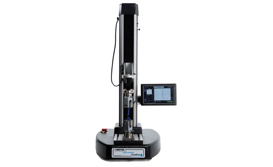

Chatillon-CS-Series-Single-Column-Digital-Force-Tester
This is a universal force tester with an integrated electronic load cell. Source: AMETEK

Universal Force Testers: Universal force testers use a load cell with integrated electronics instead of a force gage. The electronics can be mounted to the frame in the form of a tablet or console or built into the frame enclosure. The test programs are stored in the electronics and can be password protected. These devices feature USB and serial data outputs and can use dedicated or non-dedicated load cells. The PC also stores test results and plot the graphs from data points that also can be exported to a data acquisition system.
