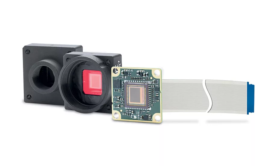

Board level cameras for embedded vision applications. Source: Basler

An embedded vision system comprises a camera without housing (known as a board-level camera) connected via an inexpensive cable directly to a processing board (aka, embedded board). The processing board handles the same image processing that was performed by the PC in the classic machine vision setup.

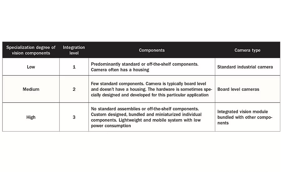

COMPARISON OF EMBEDDED VISION SYSTEMS WITH STANDARD VISION SYSTEMS
A clear distinction between “embedded vision” and standard machine vision systems is not easy sometimes. One way to make a classification is to break them down into three segments.
Segment one comprises a classic vision system with a camera and a separate PC. Segment two includes systems based on board-level cameras combined with application-specific hardware, like small form-factor PCs. In segment three, you will find a highly integrated system with a strong degree of miniaturization and just a few or no standardized components at all (see overview chart). For example, in segment one and two you will usually find camera systems using GigE, USB, shielded cables, and so on, while in segment three, you are more likely to find low-level interfaces like LVDS with ribbon cables.
In other words, along the path from stage one to stage three the camera becomes smaller and the number of standardized components shrinks.
