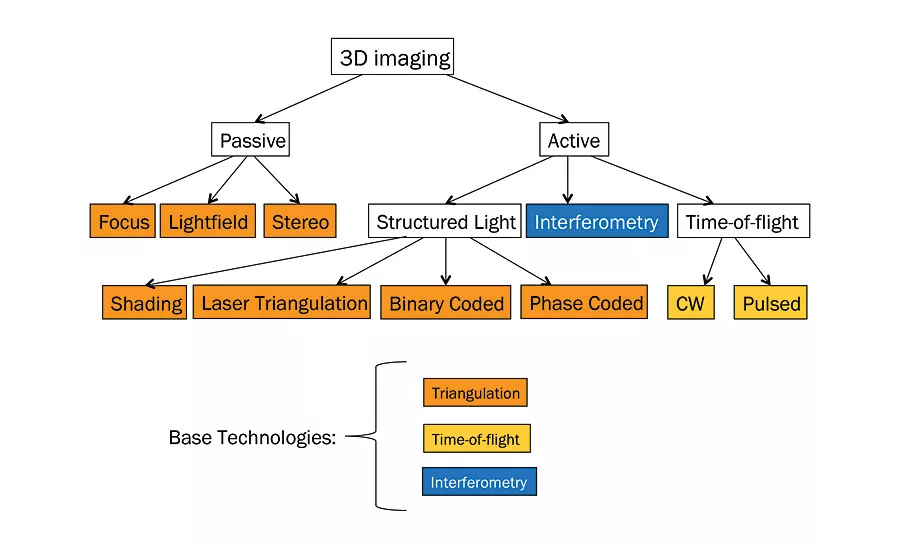

Chart 1: This map of 3D technologies illustrates the different types of 3D imaging by whether they are active or passive, and whether they use triangulation, time-of-flight, or interferometry. Source: SICK

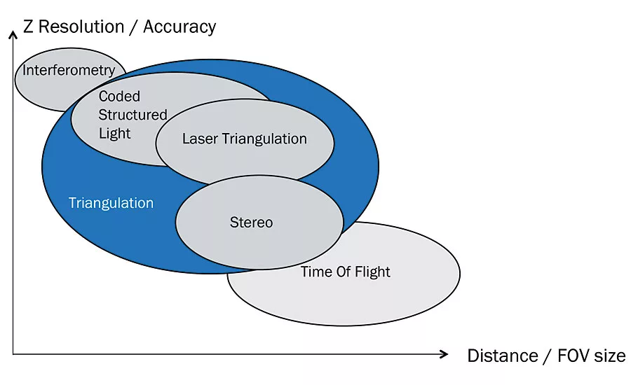

Chart 2: This chart shows how several 3D technologies compare when considering Z resolution and accuracy versus distance and field of view (FOV). Source: SICK

Capturing the third dimension can be done in many different ways, and each of the machine vision technologies available has its pros and cons. Three-dimensional imaging can be broken into two main categories: passive and active. From there it can be broken into much more specific techniques. Passive techniques include depth from focus, light field, and stereo. The main active techniques are based on time-of-flight, structured light, and interferometry.
Three-dimensional imaging can be further broken down into how the image is actually acquired, including snapshot and scanning methods.

Laser triangulation uses a laser line and a camera to collect height profiles across the object. The profiles are put together to create a 3D image while the object is moving. Since the height profile acquisition requires object movement, the method is a scanning technology. Laser triangulation has higher measurement accuracy than time-of-flight, but it has a more limited measurement range. In addition, occlusion is possible where the camera cannot see the laser when it is hidden behind an object. Typical applications include log/board/veneer wood inspection, electrical components/ solder paste inspection, and food and packaging inspection applications. Below are some of the key advantages and limitations of laser triangulation:

Time-of-flight (TOF) 3D cameras create 3D images by using snapshots. This means no object or camera movement is needed. The technology measures the time-of-flight of a light signal between the device and the target for each point of the image. By knowing the phase shift of the signal time arrival relative to the initial signal, the distance between the device and target can be derived. The result is an instant 3D image of the target. Time-of-flight is well suited for applications with a large field-of-view and working distance over 0.5 m.

Stereo imaging works similar to human vision and provides snapshot 3D images without the need for external movement. It combines two 2D images taken from different positions and finds correlations between the images to create a depth image. Unlike laser triangulation and TOF, stereo technology does not depend on a dedicated light source. However, to find correlations the two images need to have sufficient details and the objects sufficient texture or non-uniformity. It is hence suitable for applications with a large field of view and for outdoor usage. To obtain better results, one may need to add those details by illuminating the scene with structured lighting.
