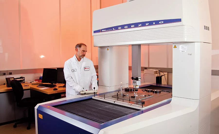

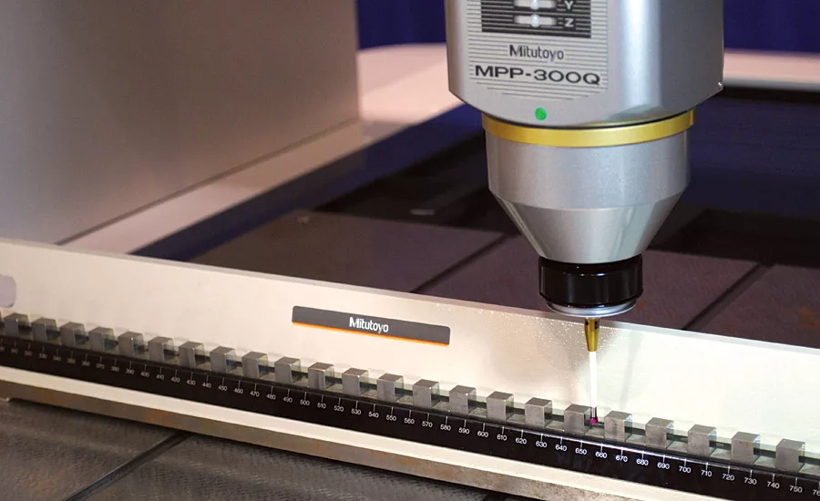

At the Mitutoyo America Calibration Lab (Aurora, IL), CMMs measure with an uncertainty of only a few millionths of an inch. To achieve that accuracy takes an extreme understanding of the machine, its calibration, the probe system and the influence of temperature. Source: Mitutoyo

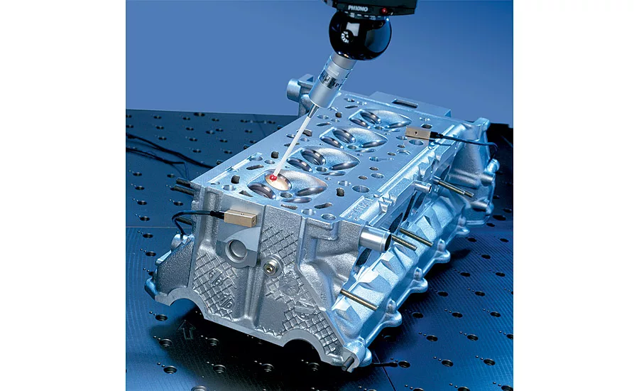

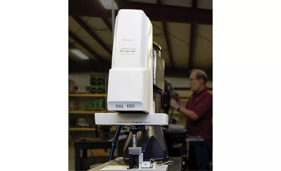

CMMs are routinely found on the shop floor, often running in automated cells. Source: Mitutoyo
CMM measurement

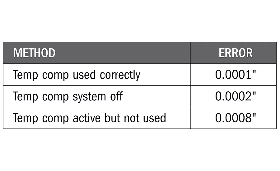

Many CMMs have built-in temperature compensation systems that include workpiece temperature sensors. These systems should be either used correctly or completely turned off by the CMM manufacturer. If they are simply not used, but still on, then unexpectedly large errors may arise. The table below shows a case where a 20” length is measured on a steel part at 75 F.

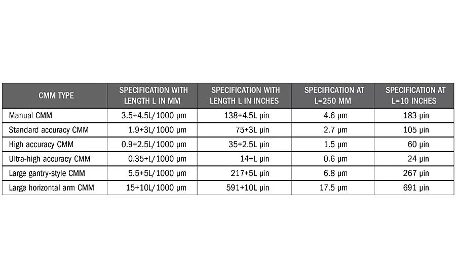

The accuracy of CMMs are specified and calibrated in accordance with ISO 10360-2. The most important specification, which covers linear and volumetric length measuring accuracy, is the E-test. The specification was originally just called E (in 1994), but in later editions of the ISO 10360-2 standard, the specification was called MPEE (2001) or E0,MPE (2009), where MPE is the maximum permissible error. The table below shows typical CMM manufacturer stated specifications for the E-test based on the type of CMM. When used properly, in the permissible environment, these specifications represent the maximum error of the CMM when measuring length.

CMMs, instead, are calibrated by performing a series of length measurements across the measuring volume of the CMM. Well-documented standardized test procedures have been available since the mid-1980s, the latest of which is the international standard ISO 10360-2:2009, which was adopted in the United States as ASME B89.4.10360.2. The primary test is simply known as the E test, where E stands for error of indication. The test involves making 105 different length measurements across the measuring volume and in various orientations, and then comparing the test values to the manufacturer’s stated specification. The most common reference standard used for CMM calibration is a step gage, which is not unlike a series of different length gage blocks. Other reference standards, such as a laser interferometer which is popular for large CMMs, are also permitted per the latest ISO 10360-2 standard.
A CMM calibration following the ISO and ASME standards is an overall system verification. If the test fails conformance, then adjustments may be needed. To complete the adjustments, additional measurements, such as the squareness between two axes, may need to be measured and corrected. If the test passes, then the CMM operator has confidence in the overall general accuracy of the CMM; however, as CMMs can be used for so many different tasks, consideration must be given to understanding the additional errors due to the specific use of the CMM.

Many CMMs today come equipped with built-in temperature compensation systems. These temp comp systems can do an amazing job of compensating and correcting large thermal errors associated with either the CMM or the measured part not being at the standard reference temperature of 20 C (68 F). However, if a temp comp system is not being used correctly, these systems can introduce extremely large errors.
Consider a situation where a CMM operator decides not to use the system by ignoring the workpiece sensors or setting the workpiece coefficient of thermal expansion to zero. The operator may be thinking he will instead follow traditionally good measurement practice of thermally “soaking out” the measured part on the measuring equipment to bring them to the same temperature, and therefore, not need to correct the thermal errors. While this approach has worked for decades on traditional measuring equipment without temp comp, the operator may be unaware that the temp comp system is still actively working to correct the CMM, and only the CMM, to 20 C, while the workpiece is not being corrected. By ignoring the use of the workpiece sensors, a temperature differential is created that could result in significantly large and unknown errors.
For CMMs with temp comp, the best approach is to place the workpiece temperature sensors on the measured part. If that approach is not convenient, then the temperature sensors could be placed near the measured part, for example, integrated into some fixture holding the part. In this manner, a relatively accurate measurement of the part temperature can still be made even if the temperature sensors are not in contact with the part. If there is no plan to use the workpiece temperature sensors, then the entire system should be turned off, which can usually only be done by a service engineer from the manufacturer of the CMM.
