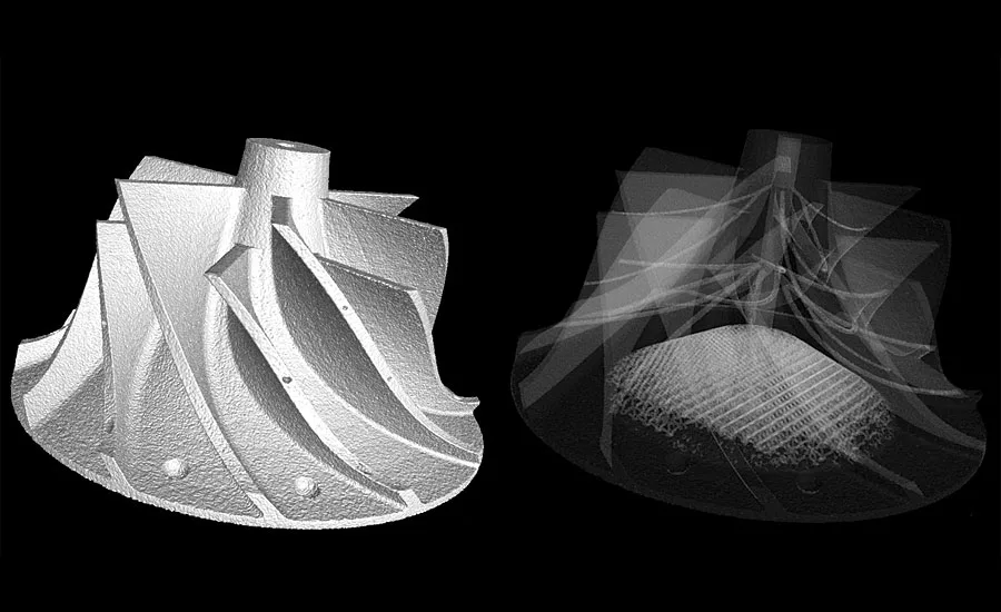

With traditional manufacturing processes, a few radiographs at specific orientations can often give peace of mind. But with additive layer manufacturing (ALM), the whole part needs to be inspected. What do we look for when checking the structural integrity of ALM parts?

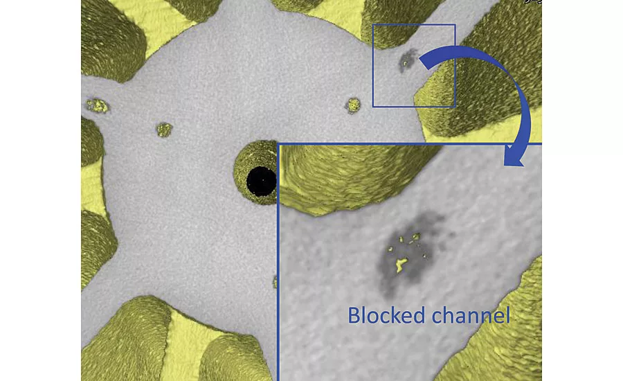

  • Powder residues blocking channels
  • Defects (voids and inclusions) – porosity, contamination, cracking
  • Departure from the CAD model – dimensional analysis, wall thickness measurements, warping.
For example, a mold made using selective laser melting is designed to make a small knocker for a watch mechanism. Micro CT can determine the cooling and flow channels built in by the ALM process to an accuracy of 50-100 µm (depending on acquisition parameters). From flow/cooling simulations, this is known to be of sufficient accuracy for the purpose.

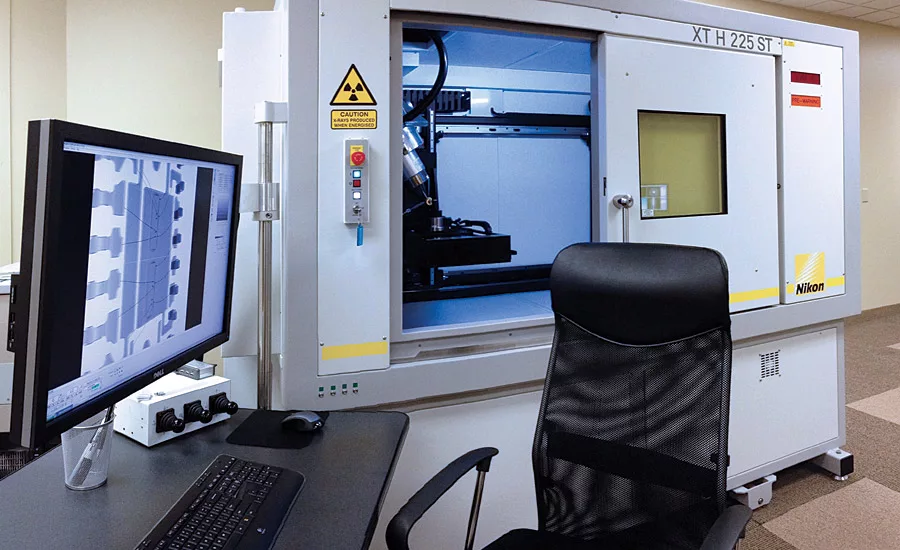

The size of sample which can be scanned with CT depends on the material it is made of and the energy of the X-ray source (measured in kilovolts (kV)). Larger lower density samples can be scanned, as can smaller higher density samples.
Typical largest samples are:
  • 225kV – aluminum piston heads; diesel injectors
  • 450kV – aluminum cylinder heads; aircraft turbine blades
Maximum part size also tends to be limited by the size of the detector, but also by the penetrating power of the X-rays. This decreases as material density and atomic number of the material increases. Much more plastic can be penetrated than steel, and much more steel than lead.

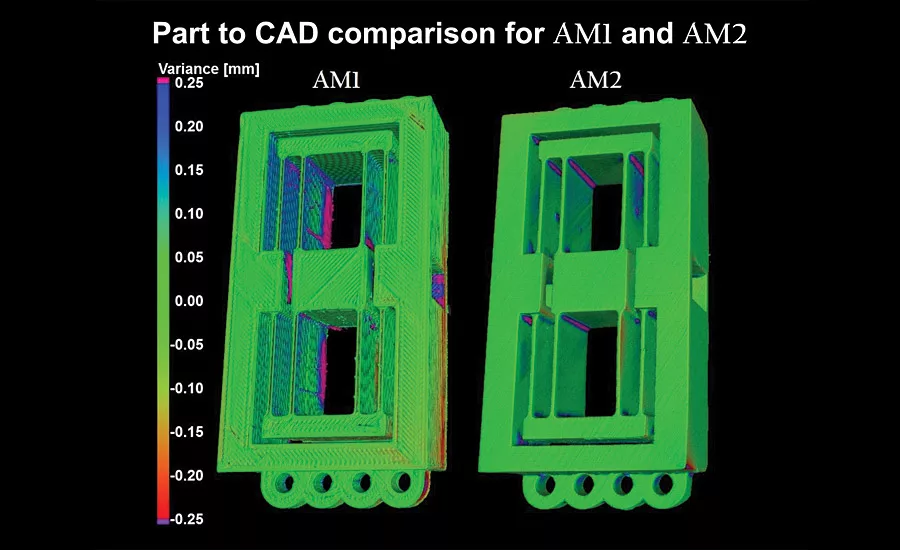

In this research, a flexure mechanism fabricated by additive manufacturing is being investigated by X-ray CT scanning methods. A first flexure sample (AM1) was manufactured by fused deposition modeling (FDM), which for pedagogical reasons and with the aim of illustration will be called AM1. A second sample (AM2) was manufactured by stereolithography (STL). For reference, the FDM and STL processes have in general printing resolution of approximately 100 µm and 0.5 µm, respectively.
Micro CT scans show variance analysis for both AM1 and AM2 flexures against the original CAD model. From the measurements, it can be seen that deviations from the nominal geometry (CAD model) rise up to ±0.25 mm and larger when using the AM1 process. In contrast, the AM2 process generated part-to-CAD deviations mostly between ±0.1 mm, with a few exceptions particularly around surface edges or corners.

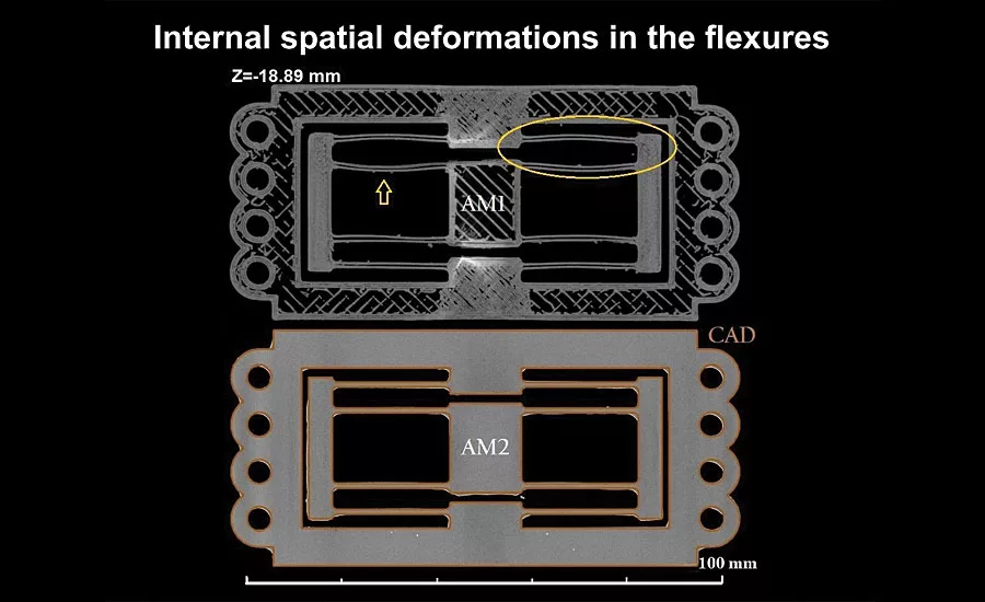

In addition to external checks, a cross section of AM1 shows residual internal and spatial deformations. On the other hand, the manufactured part generated by the AM2 process (bottom figure) does not reveal the presence of major deformations in the thin-walled flexure leaf structures.
