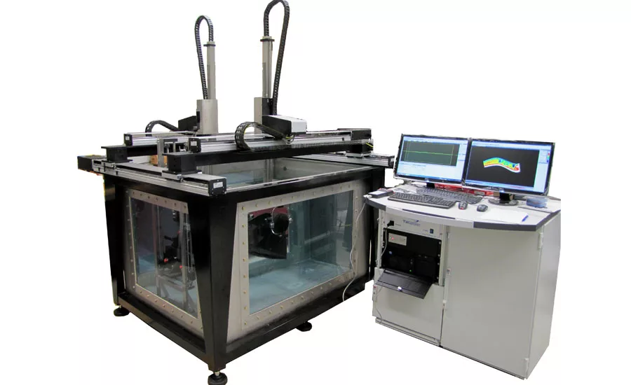

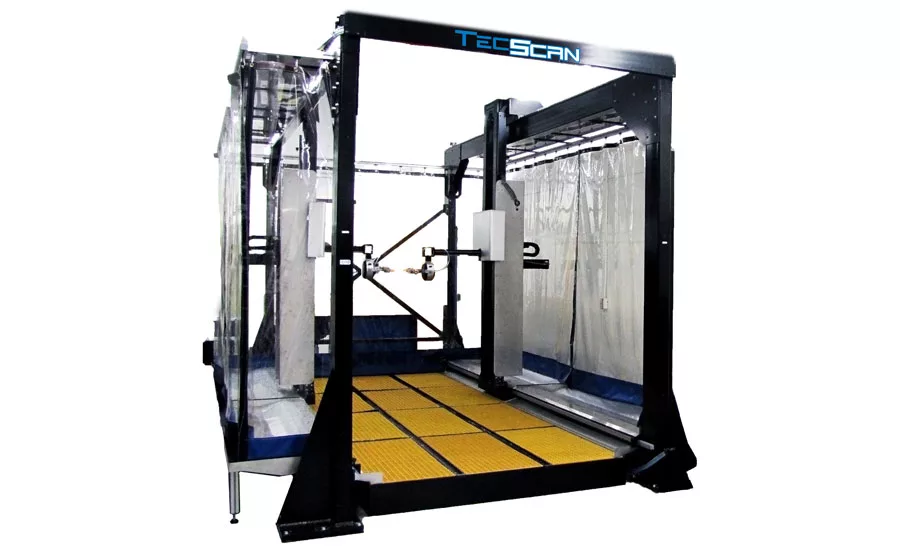

Ultrasonic squirter gantry system and immersion tank. Ultrasonic immersion tanks and squirter gantry systems are well suited for automated inspection of aerospace parts.

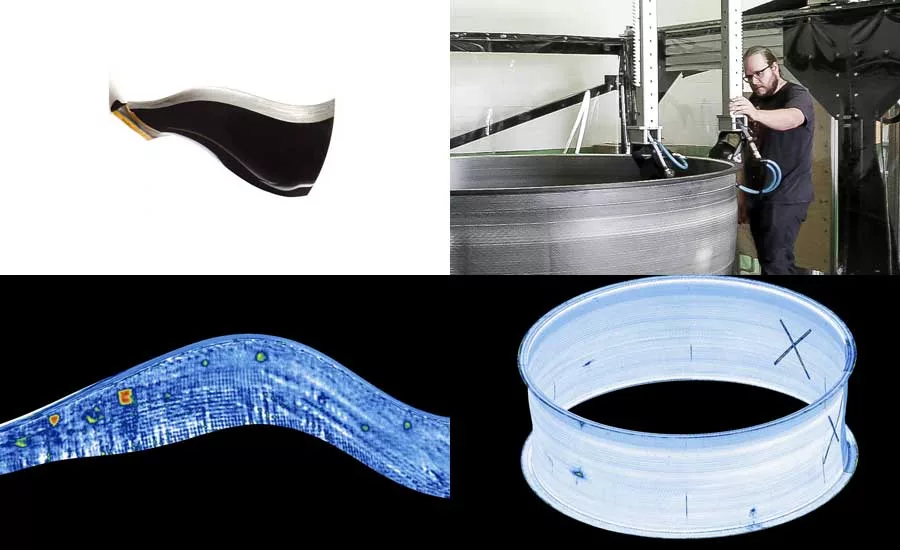

C-Scan image of sample engine fan blade. This example shows inspection result of aircraft engine composite fan blade and fan case. Automated ultrasonic testing and 3D contour following inspections were performed to detect defects. The first figure shows an example of a C-scan image obtained on a sample composite fan blade containing disbonds. These were created with Teflon inserts between the layers of the composite blade. The C-scan result represents a color-coded 3D presentation of the data collected during an automated inspection of the blade. The red spots on the C-scans represent the detected disbonds defects. Similarly, the adjacent figure displays a C-scan with defects obtained from a tested engine fan case sample.

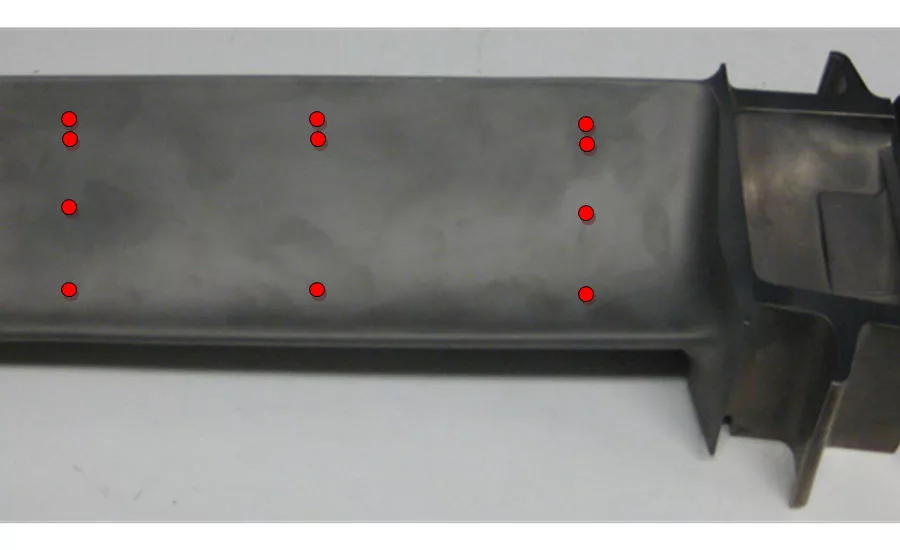

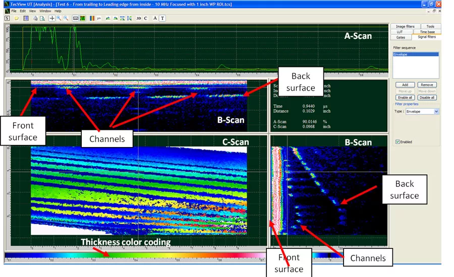

Thickness is measured at different positions on the blades by setting up gates on the front and backwall echoes.
Thickness is measured at different positions on the blades by setting up gates on the front and backwall echoes. This example shows results of an automated point-by-point thickness control of sample turbine blade. The location of predetermined wall thickness measurements points on the blade were manually programmed to allow blades of the same model to be automatically measured.

blade imaging with colors

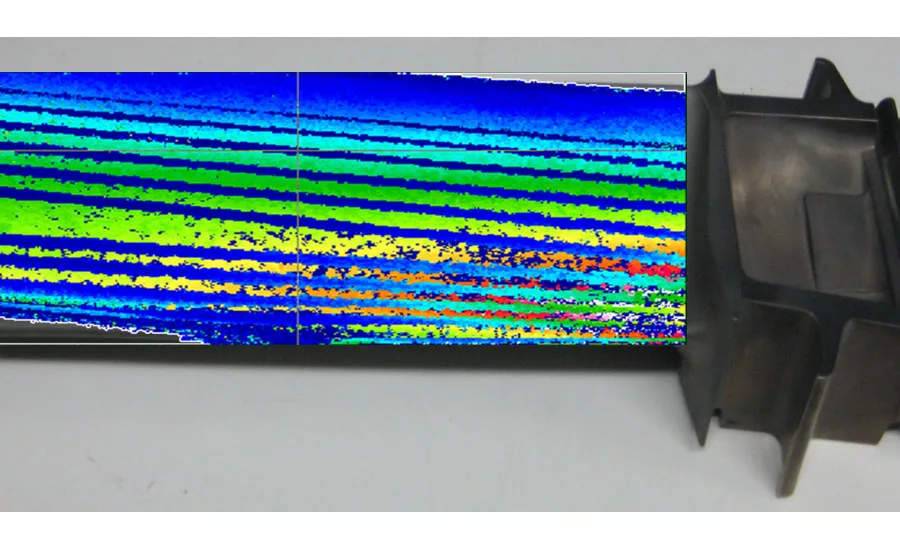

Superposition of the C-Scan image and a picture of the blade showing the approximate coverage of the C-Scan thickness mapping. The C-Scan result clearly shows all the cooling channels as well as their depth relative to the full thickness. The dark blue lines running from left to right of the C-Scan represent the holes in the blade. Variations in the depth of the holes and of the full thickness can also be observed by color variations in the thickness mapping. Such a representation allows measuring the thickness at any point of the C-Scan.

With the use of automated ultrasonic testing systems, we are able to decrease the inspection time, increase imaging and detection capabilities as well as conduct reliable and repeatable inspections. Ultrasonic immersion tanks and squirter gantry systems are well suited for automated inspection of aerospace parts. Parts with complex shapes and geometries require immersion tanks and squirter systems with advanced scanning tools, such as contour following or 3D inspection software. These tools allow inspectors to set up inspection scan plans by teaching the part’s surfaces or importing a CAD drawing of the part.

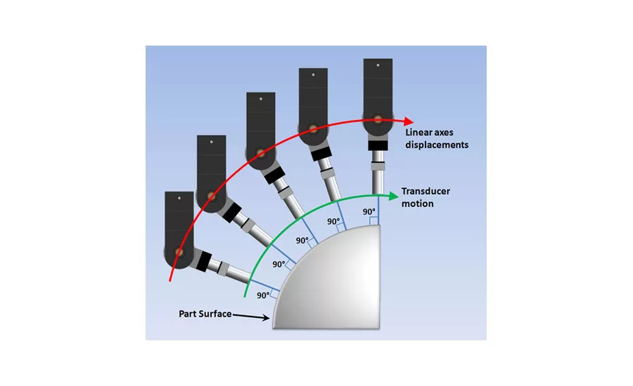

Contour Following
Contour following can be described as the system’s ability to perform a controlled displacement of one or multiple axes, with the objective to move around a curved, round or inclined surface with constant transducer orientation and distance (water path). When performing an ultrasonic inspection with a large immersion or squirter system, the orientation of the transducer must be controlled with a high degree of precision in order to follow the parts contour adequately.

New generation fan blades and cases are designed for medium-haul airliners and constructed from composite materials. For safety and reliability requirements, automated ultrasonic testing is performed to detect any manufacturing anomalies/defects. The biggest challenge to inspect these parts is that they have complicated curvatures, surfaces with free form shapes, no axis of symmetry and varying thicknesses.

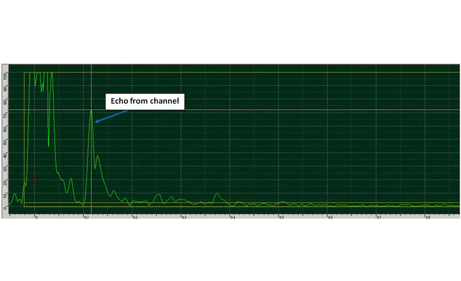

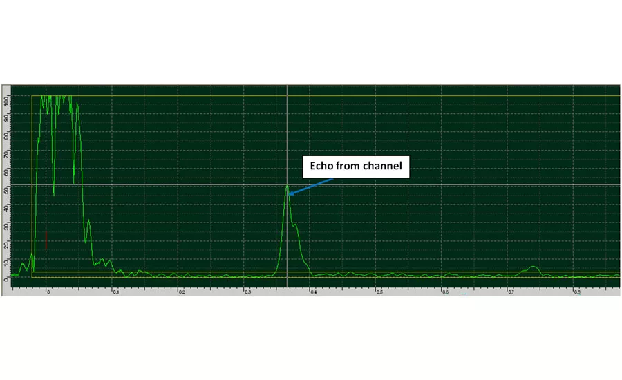

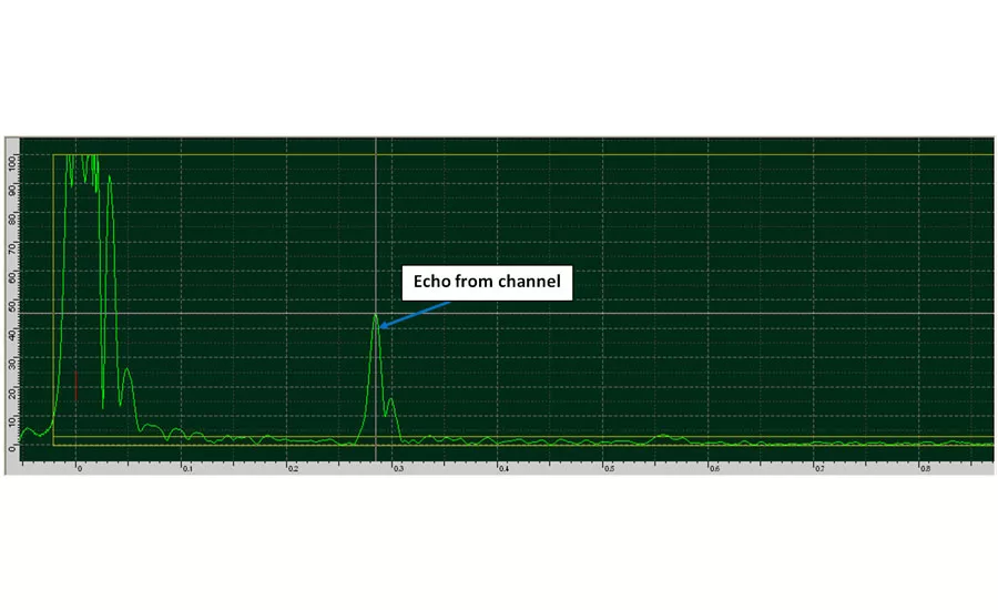

Turbine blades used in aircraft engines are manufactured by investment casting. They are designed with internal air cooling channels which allow the blades to operate under extremely high temperatures. Thickness variation at the cooling channels, caused by the casting process, can affect the blade capacity to operate at elevated temperatures. Therefore, to ensure structural integrity of the turbine blades, it is important to control the material thickness at critical positions. Ultrasonic testing is typically done with the use of thickness measurement instruments with contact ultrasonic probes. This manual thickness measurement approach can be both time consuming and subject to human error. For proper and precise wall thickness measurement of multiple turbine blades, an automated inspection solution is highly desirable.
Wall thickness measurement of turbine blades can also be achieved from C-Scan thickness mapping. Using contour or surface following scans the full thickness mapping can be performed on large areas of the blades. The advantage of this approach is to eliminate uncertainties related to the blade’s channel positions as well as to detect any structural imperfections, including cracks and inclusions.
