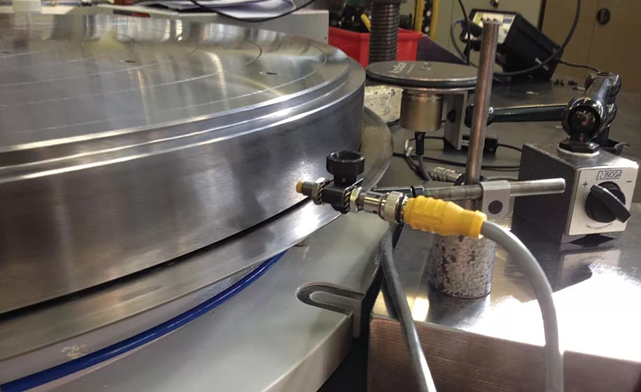

Well, that level of accuracy can be achieved with high precision rotary tables. These can deliver precision geometry with axial performance well below 0.0005mm and positional accuracies to ±0.5 arc-seconds (±0.00014°).

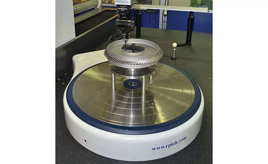

Using a rotary table on a CMM will improve process efficiency and productivity by reducing setup and process times. A rotary table will also greatly increase a CMM’s available measuring volume thereby providing greater flexibility in what can be measured. And last but by no means least, a rotary table will also significantly improve overall measurement accuracy of a CMM, thereby reducing uncertainty.
Rotary tables enable very precise measurement of many geometrical characteristics, including angle, roundness, concentricity, parallelism, flatness and runout. They are used with: probes such as plunger, transducer and capacitance; optical such as autocollimator and laser interferometer; and electrical: oscilloscope and voltmeter.
Rotary tables enable accurate measurement of symmetrical/prismatic components such as rotor discs. In the measurement of a rotor disc, a CMM without a rotary table would require a machine with a large measuring volume. However, deploying a rotary table will reduce this volume significantly. This is because the volume of the CMM is directly related to the diameter of the disc as voluminous styli systems are usually required to measure a workpiece from all sides. This means a large proportion of its measuring range is required just to ensure collision free movement of the stylus around the part.
However, the introduction of the rotary table removes this requirement as the rotor can be presented directly to the stylus removing the requirement to access all sides. This in turn simplifies the stylus system allowing the measurement of larger workpieces in relation to the available measuring range, saving aerospace manufacturers both time and money.

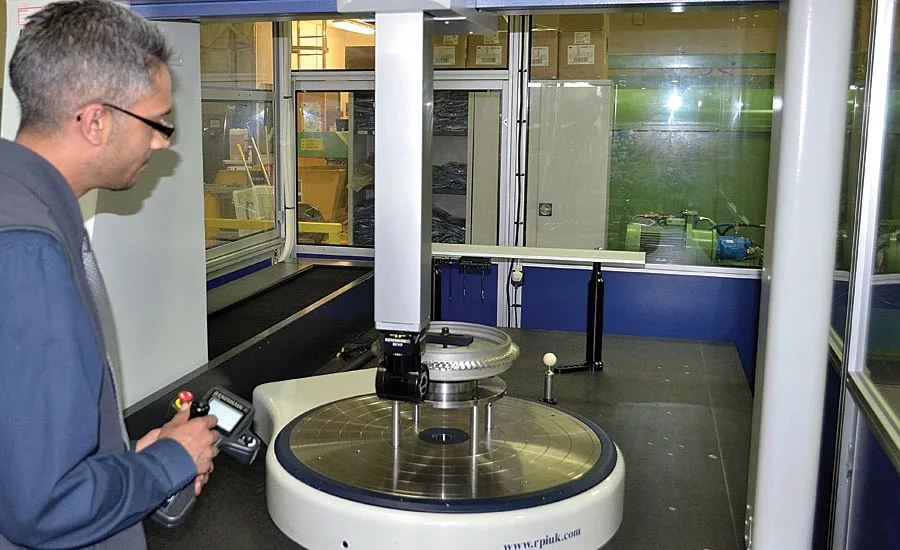

As well as significantly improving overall measurement accuracy and reducing uncertainty in CMMs, rotary tables also greatly increase a CMM’s available measuring volume thereby providing greater flexibility in what can be measured.
Some tables have been specifically designed as a fourth axis for any high precision CMM to simplify measurement procedures, increase application range and measuring volume of symmetrical or prismatic components, including scanning applications. This is particularly important for large turbine disks for gas turbines or for airplanes. However, they are also starting to gain traction for smaller, lower measurement volume applications typical in the automotive industry.

Air bearing spin tables are becoming more popular and rely on air lubricated hydrostatic bearings which provide very high radial and axial stiffness. This type of bearing offers significant advantages over conventional rolling element bearings permitting operation with minimal drag, vibration and mechanical noise.
The design of these bearings ensures axial laminar flow between shaft and housing compared with conventional orifice entry arrangements thereby ensuring exceptionally good motion geometry of less than 0.0001mm for axial and radial runout.
These tables can be combined with direct drive motors and high accuracy angular encoders. The encoder couples directly to the motor control system, which has its own high-resolution interpolator ensuring precise positioning and repeatability.
