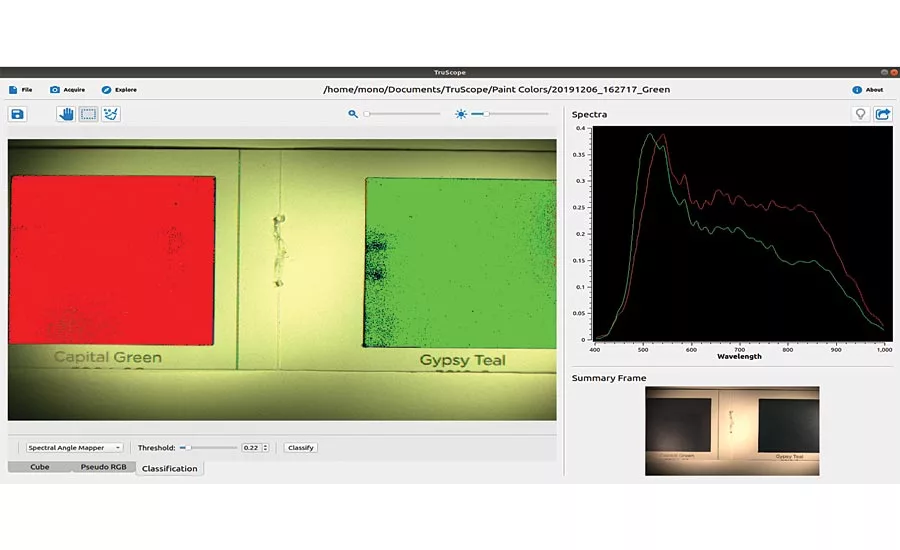

This image shows the Spectral Angle Mapper classification of paint samples, demonstrating detection of the differences between otherwise indistinguishable pairs of greens (capital green and gypsy teal). The sample as they would appear to the human eye are in the bottom right corner.

This image shows the Spectral Angle Mapper classification of paint samples, demonstrating detection of the differences between otherwise indistinguishable pairs of yellows (wild daisy and lemon twist). The sample as they would appear to the human eye are in the bottom right corner.
