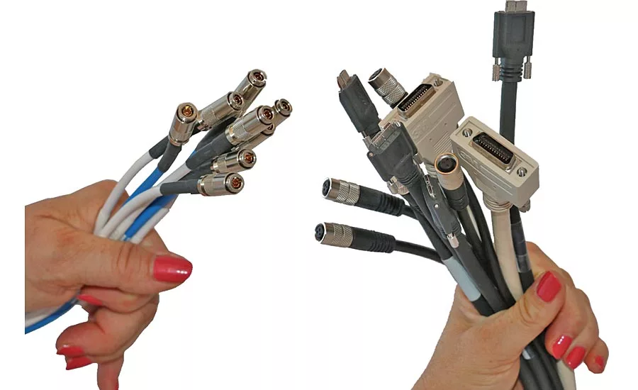

It is important to take cable length into account for CoaXpress and USB.

But you say you don’t have to worry about that frame grabber stuff with USB3.1 Vision. True, but the question is what do you need to do with this imaging system in your overall architecture and application. Well, first what resolution and frame rate do you need? That will dictate what data rate you will need. If you are below 400 MB/s (2.4 Gbps) the winner is generally USB 3.1, unless cable length is an issue for your system because USB 3.1 can only go about three meters max (though some report being able to reach eight meters passively). But, you say, what about cable extenders and active cables? Those will certainly bridge the cable length gap but eating up the difference in cost of a frame grabber rather quickly.
