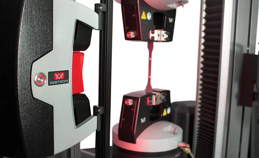

Video extensometers can be used with adjustable gage lengths for tension testing.

After almost 20 years of calling for a 50 mm gage length, the 2012 update to ISO 527-2 introduced a change that now requires a 75 mm gage length extensometer be used for type 1A specimens, with a 50 mm gage length only being acceptable in quality control applications. The extensometer must conform to be an ISO 9513:1999 class 1 device, resulting in an absolute accuracy requirement of 1.5 microns for a 75 mm gage length. With such high accuracy requirements, reporting the modulus of sub-sized specimens may not be possible due to the unavailability of devices with sufficient accuracy.
The latest version of ASTM D638, however, continues to call for a 50 mm gage length for the most preferred size of test specimen. To make sure you always have an appropriate device on hand, the use of automatic contacting extensometers or non-contacting video extensometers can provide a means of changing the gage length without having to buy a new device. These devices also allow you to test to multiple standards and offer the flexibility to adjust to continual changes in test standards.
