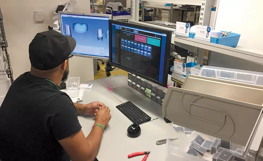

Another example of the future of quality systems can be seen at Dentsply Sirona, a company whose comprehensive dental solutions include product brands across consumables, equipment, technology and specialty products. Dentsply Sirona’s Implant division provides solutions for all phases of implant dentistry, including the design and manufacture of patient-specific, implant-supported abutments and crowns through its Atlantis portfolio.
Because Atlantis solutions are as unique as each individual patient for which they are designed, every product package contains a varying combination of components, such as screws and insertion guides, which the clinician will need to install the final dental implant-supported restoration. Every package is one-of-a-kind; and there are hundreds of thousands of component combinations. Obviously, it is critical to get the right components in the right box.
To successfully achieve this consistent accuracy in packaging and delivery, Dentsply Sirona Implants used the manufacturing app platform to design and deploy a quality app that powers its product verification station and completely guides operators through this complex process. A manufacturing app running on a standard computer displays simple instructions with a complex back end system that talks directly with Dentsply Sirona Implants’ ERP system. At the same time, an integrated pick-to-light system illuminates bins of components. The whole validated process dynamically guides the operator through the packing sequence, reducing the risk of making a mistake when preparing an order. Overall quality outcomes are no longer solely dependent on the operators. This enables standardized workflow, reduces training time for new operators, increases throughput, and yields better quality outcomes.
“The system allows us to control a highly complex process with hundreds of thousands of variations while leveraging the investment we made in our existing backend systems,” says Dan Ron, Dentsply Sirona Implant’s senior process engineer. “The system is self-serviced so we are able to customize the manufacturing apps to our needs, which allows us to solve our own problems and reduce our dependency on external vendors and better focus our IT resources. Today, we are capable of having real data with real evidence from our process that helps our staff have more visibility of process efficiency, while allowing us to effectively manage our patient-specific components for each and every order.”
