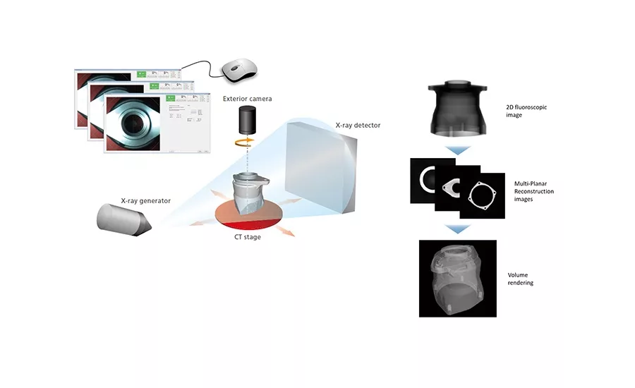

In general terms, a computed tomography scanner has an X-ray source, a detector panel, and a rotary table. The X-ray source takes hundreds or thousands of images of the test specimen as it rotates on the turntable. Computer software then reconstructs the images into a 3D volumetric model containing billions of voxels. Each voxel is a cube with a discrete x-y-z position and density. The model can then be digitally cross-sectioned and otherwise inspected for a range of analyses including voids, inclusions and other defects. Computed tomography scanners today can also make metrology-grade measurements of both internal and external features. Other popular modes of use include wall thickness analysis and carbon fiber composite material analysis, where software can analyze the direction and orientation of embedded carbon fibers.
Micro-focus non-destructive X-ray testing and inspection systems are widely used in many areas of research and development for morphological and structure alternation analyses, and for quality control purposes related to preproduction inspection, failure analysis, and lot inspection, according to information from Shimadzu.
