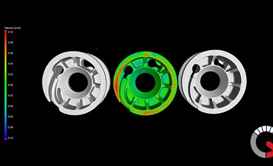

CT scanning software displays the analysis after scanning two parts and comparing both CT datasets to each other. Source: Jesse Garant Metrology Center

The CMM capabilities of modern CT scanners can also perform part-to-CAD analysis.
“Where this actually becomes really important is lots of manufacturers are starting to move over into PMI CAD models,” says Good. “When they’re designing the actual CAD models, they’re embedding the measurement info. So when you import that into Volume Graphics, it’ll actually carry over that part measurement information to keep what the original engineer’s design intended.”
