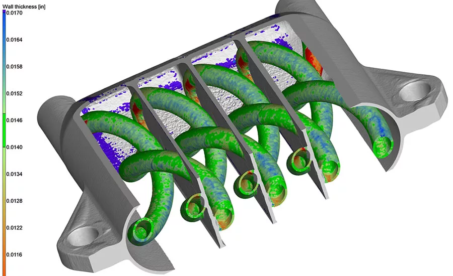

Wall thickness analysis
Wall thickness analysis of tubes designed to carry fluid and inspect channels for blockages. Source: Part by 3D Systems, Imaging by Delphi Precision Imaging

Are there any defects in your additively manufactured part? CT is used for identifying un-fused powder, missed print layers or foreign object debris or other factors that may weaken the part and cause premature failure over the part’s lifetime, or cause contamination once the part is integrated into a final assembly.
Are your parts being produced as intended? CT scan results, combined with design data such as the CAD model, can reveal deviations internally on a point by point basis. Part-to-CAD, part-to-part and nominal-to-actual analysis measures multi-axis accuracy. Shrinkage and the dimensions and orientation of critical features within additive parts can be determined.

For parts with critical interior channels such as heat exchangers, water cooled molds or fuel lines, a CT scan can reveal trapped powder, unwanted overhangs or blockages.
Porosity analysis after the completion of a CT scan quantifies the amount of porosity in a part or within a region of interest. Detailed porosity reports provide the percentage and volumes of porosities or inclusions in an entire part or a designated area of interest such as near thread tapping locations, inside of thin walls or at critical stress points.
