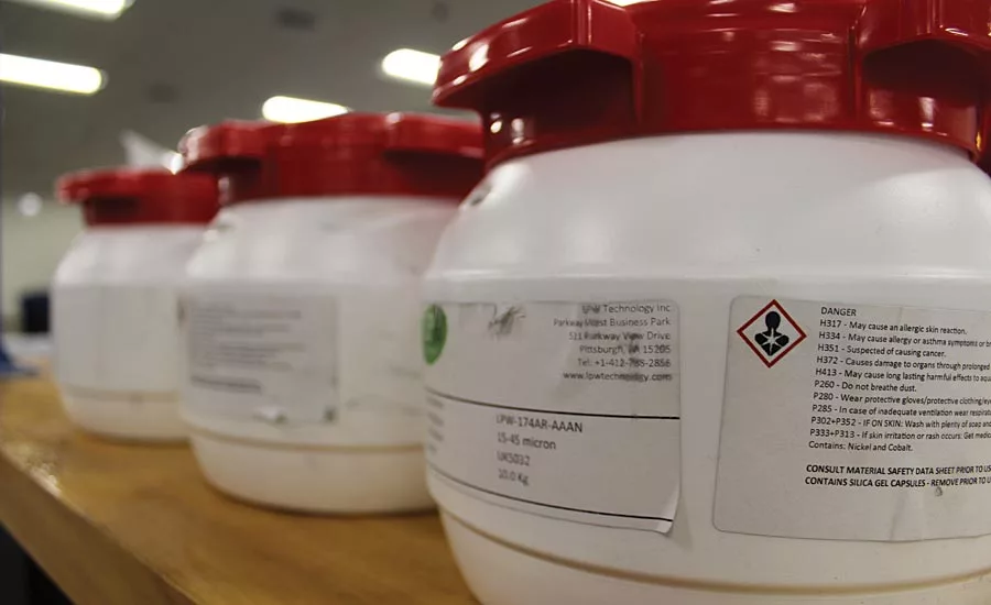

Storage and Handling of Powder
The metal powder needs to be handled and stored properly once it is received from the vendor. Proper handling includes documentation of the powder batch number or the lot number, storing the powder in humidity-controlled conditions and keeping the powder in its original canisters.
You should also record the date when the canisters are opened. Accurate record keeping is crucial during all stages of the process as it will help ensure material traceability. The powder should be handled in a clean and moisture-free environment to avoid contamination and the accidental pickup of oxygen and hydrogen.
Follow all safety requirements while handling the powder as it not only may cause injury to the handler but it could also create a condition which could trigger an explosion due to particle cloud formation by ultra-fine particles.
The Safety Data Sheet (SDS), a document that provides detailed safety handling requirements for every powder material, is an essential point of reference for anyone working with potential hazards.
