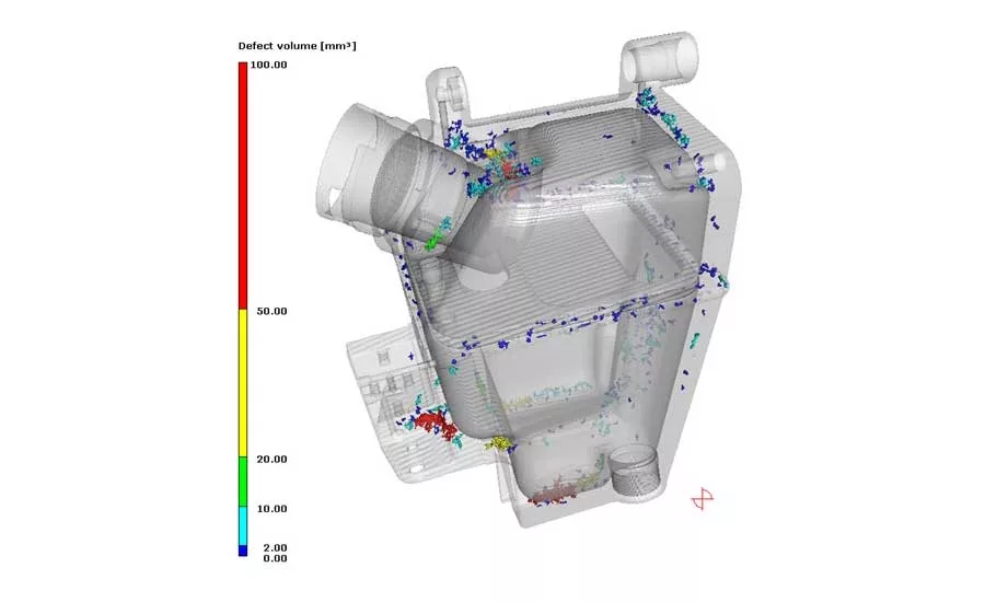

Identifying Porosity and Inclusions
This application involves a critical component of a medical ventilator constructed of two castings welded to two sides of a machined plate. CT was used to identify typical casting defects, welding defects, and porosity in both castings. The manufacturer used this information to improve the process, controlling and minimizing the porosity.
This 3D representation of the dataset of the welded plate (Fig. 1) has a transparent surface to allow perspective for identifying locations within the part. Different colors were used to represent defects of various sizes.
A cross-sectional view through the welded area shows the porosity caused by the welding process. In the cross-sectional image through the cast area (Fig. 2), flaws are color-coded to highlight their size at a glance. Defects can also be displayed to highlight their position and shape (Fig. 3). Pores smaller than a certain size are often non-critical to the function of the part. Location is also important for this application because near-surface flaws are more problematic than those surrounded by a lot of material.
