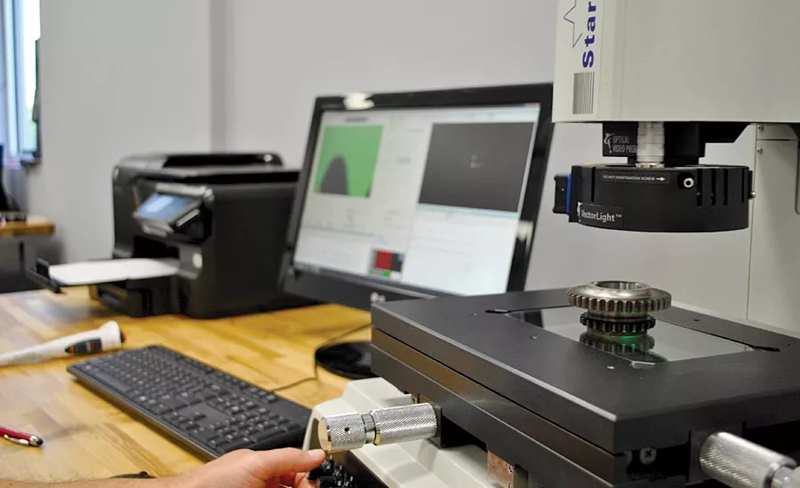

Typically inspection
Typically inspection utilizing video measurement equipment requires a dedicated technician to place parts and take measurements.
