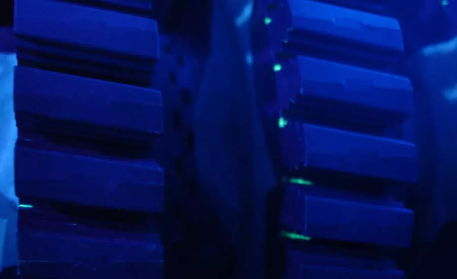

FPI Indication
FPI Indication

visual indication
Visual Indication
The first consideration needs to be the question of location, is the flaw internal or external? Determining this will quickly help you focus in on likely options and to eliminate several others. External flaws are typically found using visual testing (VT) and aided visual testing methods like liquid penetrant testing (PT), and magnetic particle testing (MT). Additionally, electromagnetic testing (ET) and ultrasonic testing (UT) can be used for detecting tighter external flaws. For internal flaws, radiographic testing (RT), ET, and UT are the primary methods for detection. There are advanced NDT methods such as phased array ultrasonic testing (PAUT), laser interferometry (LI), acoustic emission (AE), resonance inspection (RI), and several others that can also be considered.

Once you have determined location(s) and area(s) of interest, the last thing to understand is the desired sensitivity of a selected inspection. Many things can influence the sensitivty of inspections, but some of the main items to consider are: geometrical complexity, material density, surface roughness, and accessibility. I am sure that specific applications can and will have a longer list of items, but these four things should get you pretty close to selecting the right NDT method. Let’s look at each of these four items a bit closer:
Geometrical complexity – If you had a simple rod, bar, or panel, something that you can access from just about any direction, then your flaw detection method will not be driven by geometrical complexity. But, if you only have access to a single side of your test piece, or if the access you do have is smaller than the smallest NDT probe you have available, then you will need to select your method based on what the geometry will allow.
