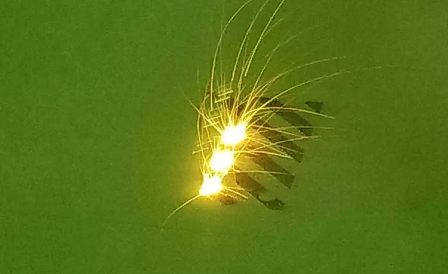

Direct metal laser sintering. Source: WeaverNDT

Before we go any further and to be clear, we are only going to be discussing the most current and dominant AM manufacturing methodologies, which are used for critical and structural components. These method groups are Powder Bed Fusion (PBF) and Direct Energy Deposition (DED). PBF includes Direct Metal Laser Sintering (DMLS), Selective Laser Sintering (SLS), Selective Laser Melting (SLM), and Electron Beam Melting (EBM). DED includes Gas Tungsten Arc (GTA), Plasma Arc (PA), Gas Metal Arc (GMA), Plasma Transferred Arc (PTA), Laser Beam (LB), and Electron Beam Freeform (EBF). Yes, that is a lot of acronyms, but all you need to remember is that PBF is powdered metal and that DED is wire or other stock raw metal.
