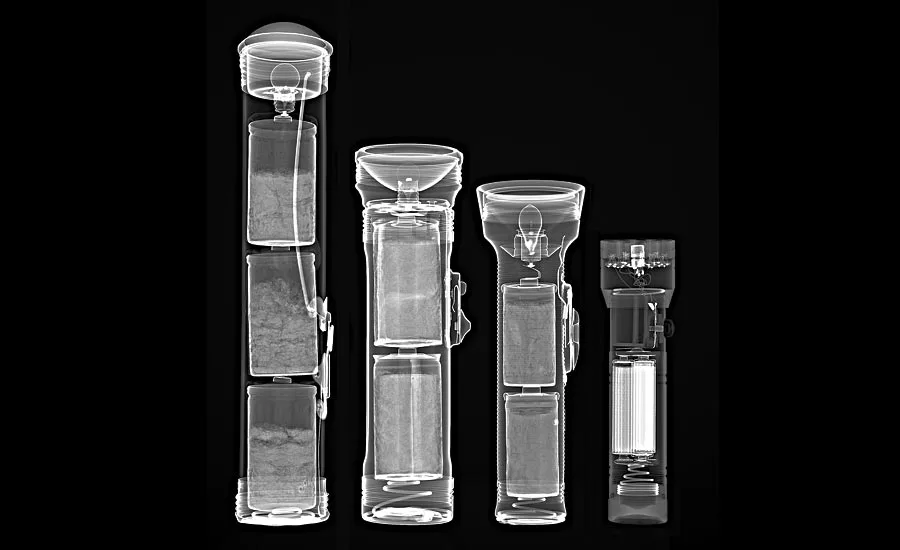

X-ray image
X-ray image depicting the evolution of flashlights (from left to right: 1900s fisheye flashlight; 1930s solid copper flashlight; 1960s ribbed chrome flashlight; modern LED flashlight with a laser pointer). Source: Nikon Metrology
