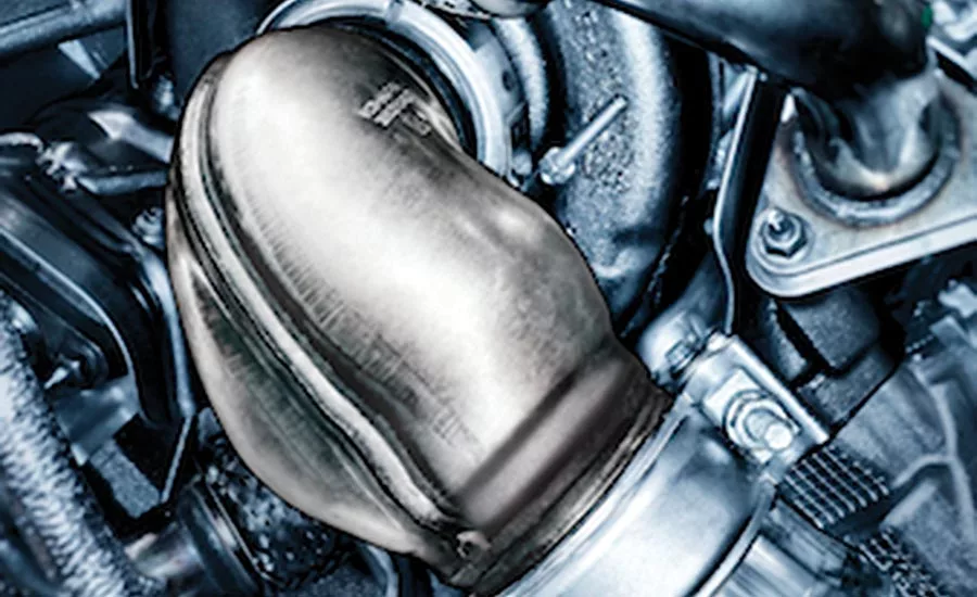

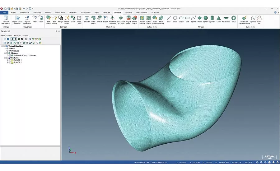

Some of today’s reverse engineering software applications include powerful processing and edit tools designed to expedite and improve reverse engineering. For demonstration purposes we’ve shown software that was used to reverse engineer an automotive turbo down-pipe, which is used to reduce exhaust gas restrictions and improve engine performance. Two-dimensional slice and edge spline tools within the software are an example of how software has evolved to quickly and easily create a surface from a mesh, a process that previously could be tedious and time consuming.

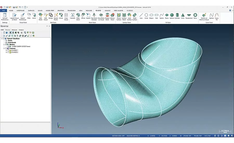

The part was measured with a laser scanner on a portable arm to capture the necessary point-cloud data that was then used to create a 3D mesh.
The open ends of the mesh are then exported to edge splines, which creates the first two curves that will define the surface. Next, the slice tool is used to create curves parallel to the ends and perpendicular to the flow axis.

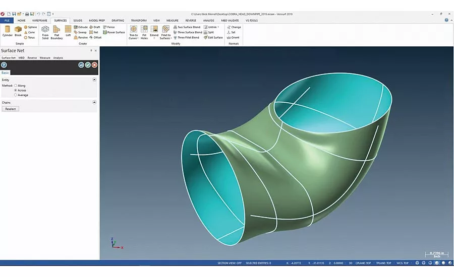

With the curve network complete, a Net Surface tool is used to create a NURBS surface, rather than a collection of patches.

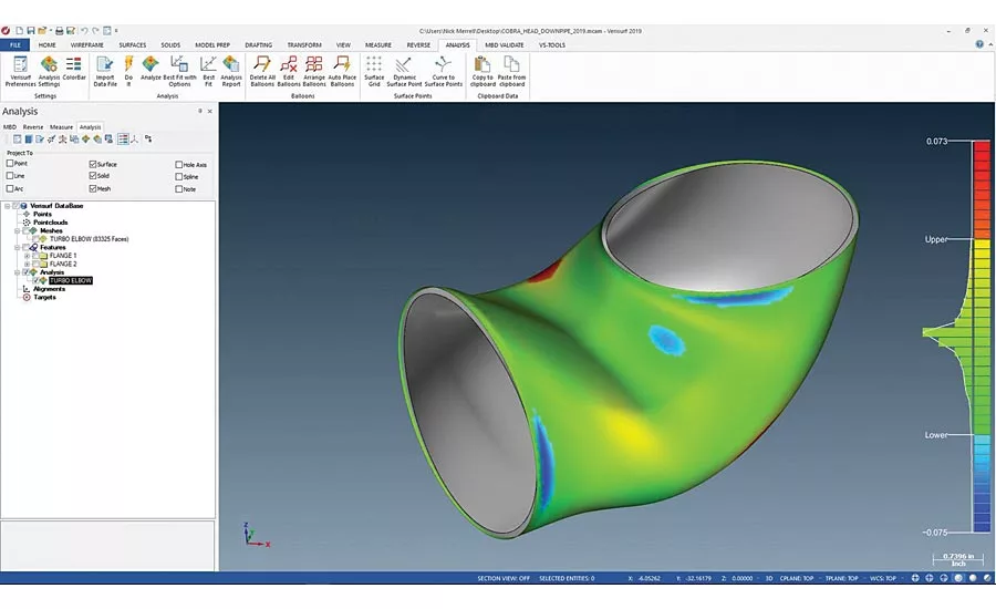

In the case of this software, reverse engineering is integrated with inspection, so the newly created surface can be compared to the original mesh to see how well the model conforms to the data.

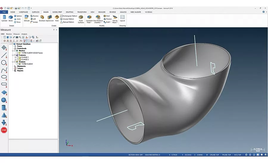

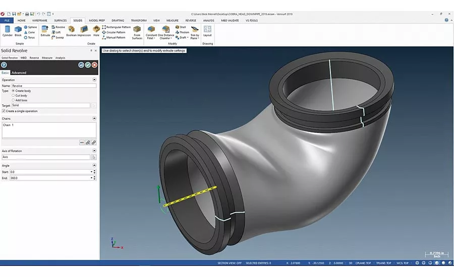

With the model confirmed it is exported to CAD to create the flanges, which were measured when the pipe was initially scanned.  A Solids/Revolve tool is used to create flanges at both ends.
The completed intelligent solid 3D model can be used for CNC machining, flow analysis, re-engineering and inspection.
