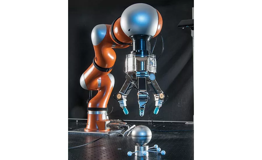

Figure 1: A collaborative robot attempting to grasp a metal sphere using a commercial 3D imaging system (top right).
