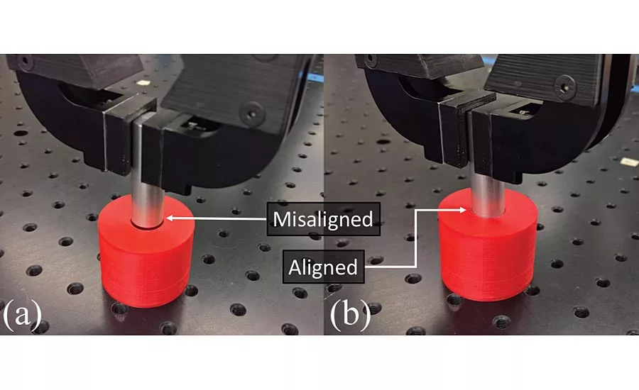

Misalignments
Figure 1: Misalignments (translation or angle errors) result in failure of operation or damage to part or robot.

One example is a quick method to align a collaborative robot with parts or other equipment (including robots) with which it is coordinating. The procedure is based upon adjustingthe robot’s tool tip with respect to registration points on its worktable, and can be scaled based on the size of the work area and application. The process is relatively simple: identify three or more points within the work area that can be reached by the robot’s tool tip, record the robot’s pose in its base frame and the respective work space coordinates, then calculate the transformation (X, Y, and Z offsets and rotations) from the robot’s base to the work area’s “home” location [REF-Marvel].
This transformation is then used to convert the robot’s pose into coordinates of any space or equipment (including sensors or other robots) to which it has been registered. The number of registration points scales with the accuracy and size of the work volume desired, with more points generally increasing performance overall. Registration can be achieved in a matter of seconds, and enables a single-task program to be reused without needing to adjust taught positions. NIST also provides additional tools to measure and report the quality of this registration, and even improve the quality of registration using machine learning [REF-VanWyk]. This registration quality assessment enables the user to quickly recognize when they need to simply re-run the registration process, rather than spend hours trying to figure out why the robot’s transformed position is not what is expected.
