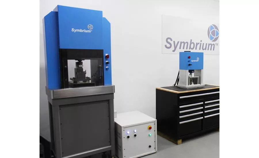

Symbrium gear test stands
Figure 1. Symbrium gear test stands. At left is 140 kNewton tester for metal gears and at right is the newest 2.5 kNewton test stand for polymer gears. The white enclosure houses the electrohydraulic motion controller and other electronics and is capable of operating multiple test stands at the same time.

Symbrium supplies test machines (Figure 1) to gear producers and gear material suppliers to develop ultimate strength data and S-N fatigue curves (i.e., plots of magnitude of stress versus the number of cycles leading to failure). Such data are used in future designs and to validate new material sources and process changes for critical gearing applications. Symbrium also operates its own laboratory using its own machines to perform contract testing for clients who may not have a lab infrastructure, or the technical knowledge required for material testing. Fully developed S-N curves with endurance limits based on 20-million-cycle protocols are routinely generated in a matter of six to eight weeks for most materials using the ultra-fast machines powered by sophisticated motion controllers. This can be a much more cost-effective option when a company needs to evaluate a new material quickly or is not in a position to purchase capital equipment and tooling. An added benefit to Symbrium engineers is the day to day operational experience using its own machines in the same way as customers, which allows them to continually improve the software and optimize the test system designs.

With the success of a 100+ kiloNewton series of servo-hydraulic testers for automotive and aerospace gear steel fatigue testing based around the RMC family of controllers, Symbrium Inc. turned its focus to a new series of testers producing 20-600 pounds of force that can be used to test the strength of polymer gears.
“There is high interest on adapting highly engineered polymer materials to automotive and aerospace markets—especially lighter loaded timing, cam and balancer gear systems,” says Kit Manchette, material engineer at Symbrium. “Recent advances in polymer chemistry and composite fillings makes certain polymers very attractive for lighter load applications where noise and vibration are of utmost concern.”
Symbrium uses the same Delta RMC to run the smaller test system as was used in the larger system. “One may think that controlling a smaller machine for plastic gears is easier than controlling the big boys,” says Yudong Zhang, senior control engineer at Symbrium. “The fact is, polymer gear testing places much higher demands on the controller.”
Both the small and large machines must maintain cyclic load amplitude at frequencies exceeding 50 Hz with less than 0.1% error. Material properties of polymers are highly sensitive to temperature and tests must be performed at elevated temperatures up to 200 degrees C to simulate the environment inside an engine or transmission. At higher temperatures, certain polymers are subject to creep—the gear teeth slowly yield plastically over time. So, the Delta controller must maintain precise load control even as the gear tooth deflection changes throughout the duration of a test. This is accomplished by monitoring the load at 200 usec while measuring dynamic tooth deflection within 1 micron using a laser sensor.
“Besides ensuring repeatability and precision, a key benefit of automating the test process is that we can run the tests unattended ‘lights out,’” said Blankenship. “We can detect very minute cracks and shut the machine down within one cycle without operator intervention.”
With the power of the flexible Delta motion controllers, both the new 2.5 kN STB-002 model single-tooth bending test machine and the 140 kN machines are rapidly becoming recognized within the North American gear community as must have equipment, with several units accumulating more than a billion cycles of fatigue data each year at major automotive powertrain and aerospace R&D groups.
