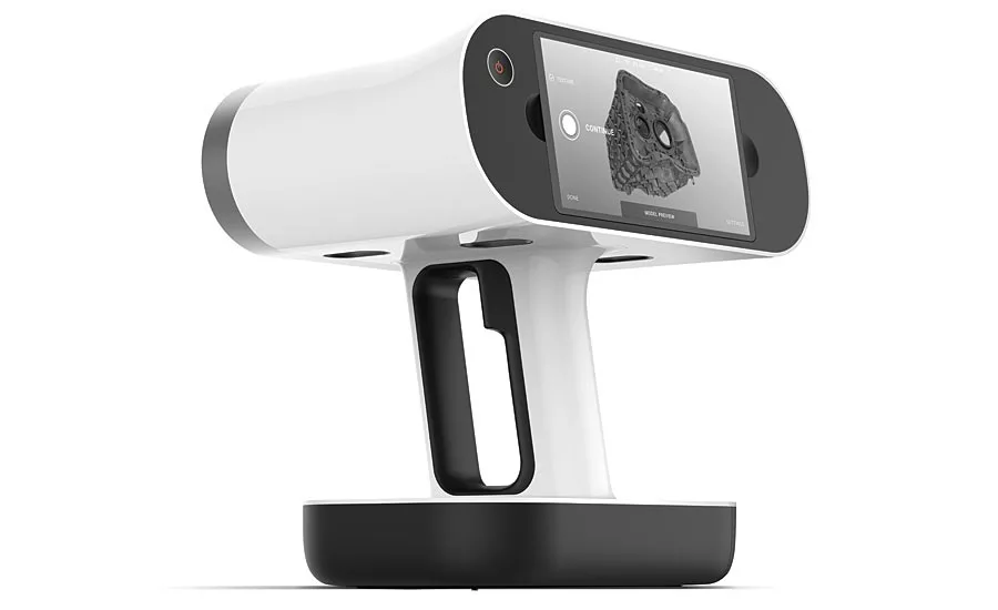

Exact Metrology announces the availability of the Artec LEO  3D scanner, produced by Artec 3D. Artec LEO is the first scanner to offer onboard automatic processing with an integrated touch panel viewer and frees users from being tied to a computer for data capture.
The scanner has a 3D reconstruction rate of 80 frames per second, making it the fastest professional scanner on the market. With its large field of view, Artec LEO can scan and process large objects and scenes quickly and accurately.
Artec LEO features data acquisition up to 4 million points/second, with a working range of .35-1.2 m.  The 3D resolution on this scanner is up to .5 mm and 3D point accuracy up to .1mm. State-of-the-art technologies including the NVIDIA® JetsonTM platform, which is the scanner’s internal computer, featuring Quad-core ARM® Cortex®  -A57 MPCore CPU and NVIDIA MaxwellTM  1 TFLOPS GPU with 256 NVIDIA®  CUDA®  Cores; a built-in 9 DoF inertial system- accelerometer, gyro and compass. This allows the scanner to understand its position and environment; and a two-in-one optical system designed to spec for the most exact texture to geometry mapping.
Artec LEO can scan in sunlight, as well as capture dark and shiny objects. As with all Artec scanners, it uses advanced hybrid technology and texture tracking. Therefore, you can point at your object and shoot. There is no need to stick targets and remove them. The texture resolution is 2.3 mp.
This handheld scanner is equipped with a 4” LCD screen to capture images of the data. The 3D light source is provided by state-of-the-art VCSEL (Vertical-Cavity Surface-Emitting Laser) technology. With no need to connect to a computer or to plug in to a main power source, users can hold the scanner and walk around freely, scanning without the worry of wires or additional equipment.
