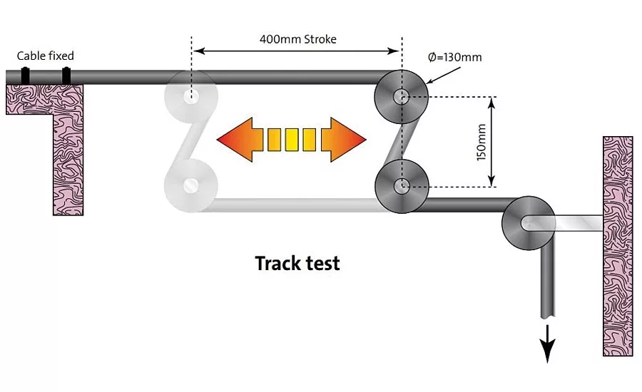

Figure 1. Track testing

Most cables have a degree of flexibility allowing them to fit into a system chassis or machine. However, for applications where the camera will be moving, such as on a robot, cables designed to withstand continuous bending and flexing over time should be used. These robot or track-grade cables are tested with repeated movements to simulate use on a robotic system or drag chains. The cables are characterized by the minimum radius angle of the flex and the number of flexes in a given time period. Drag chains are a means to protect cables which are connected to a constantly moving mechanical part. The drag chain ensures that the cable’s minimum bend radius is not underrun. Track-grade cables are typically designed to survive more than 1 million flexes with a minimum radius. Robotic-grade cables go through an additional torsional flex test which specifies repeated twisting of the cable through up to 360° over a specified length. This simulates the stress on a cable used in connection with robot arms. Most interface cables are available in these higher flex formats.
