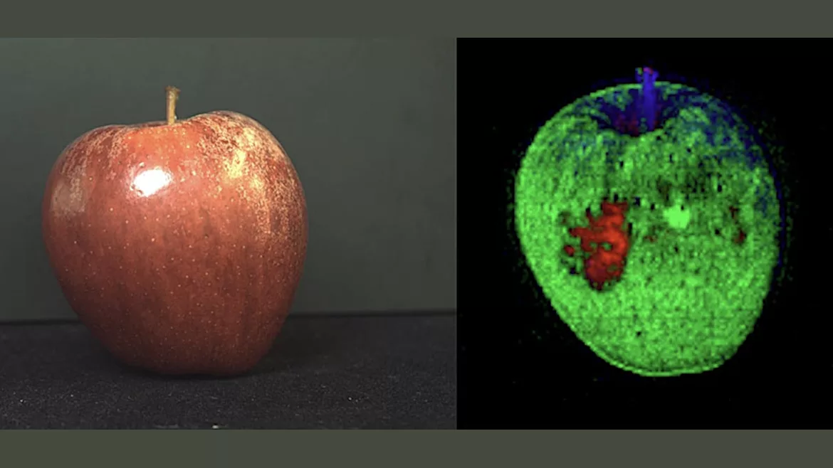

Short Wave Infrared (SWIR) Imaging
Short wave infrared (SWIR) ranges from around 1 - 5µm, although many cameras are optimized to operate in the 0.9 – 1.7µm region. These cameras need special detectors such Indium Gallium Arsenide or Mercury Cadmium Telluride. SWIR cameras produce monochrome images similar in resolution and detail to those from visible light but there are fewer commercial optical glasses available for lenses in this waveband. These glasses generally offer low dispersion which further decreases with increasing wavelength, so some elements of more expensive, high dispersion specialty glasses may be needed to produce achromatic lenses. Crystalline infrared materials, such as zinc selenide and calcium fluoride, offer high dispersion performance, but these are much less mechanically robust than glass and also more expensive, so most SWIR lenses continue to be made from glass with anti-reflective coatings. Water strongly absorbs light in the SWIR region, leading to a host of moisture distribution detection applications in farming and agriculture as well as checking fill levels of aqueous liquids in bottles. The transparency of silicon to SWIR radiation enables subsurface semiconductor and solar cell inspection including the detection of impurities in semiconductor crystal ingots and cracks in polycrystalline material while in recycling, plastic materials can be differentiated. The distinctive “fingerprints” resulting from the selective absorption of SWIR wavelengths by organic materials and plastics according to their composition can be used to uniquely identify them using hyperspectral imaging. This combines infrared spectroscopy with machine vision to produce images which are color coded according to the chemical composition of the objects being imaged (Figure 4). SWIR imaging can also measure temperatures between 250 C and 800 C making it useful in the inspection of hot glass materials early in fabrication and in welding applications.
QM VS 0322 Lenses Figure 4
Figure 4. The red area in the hyperspectral image reveals subsurface bruising not visible in the color image. Source: Stemmer Imaging (Click on the image to enlarge.)
