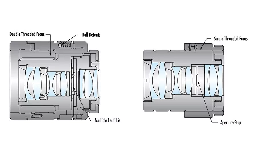

Figure 1: Standard non-ruggedized lens (left) with complex mechanics and an adjustable iris vs. an industrial ruggedized lens (right) with simplified mechanics.

Standard imaging lens assemblies typically have various moving components. To allow for a manually adjustable focus, most lens assemblies rely on a system of concentric threaded barrels. The focus ring rotates and the inner barrel, which contains the lens elements, slides forward and backward relative to the outer housing, which remains stationary. There is also an adjustable iris diaphragm with several thin metal leaves that controls the f-number of the lens. The most common way to hold the focus and iris positions in place is to tighten the rings and barrels that control them with thumb or set screws. Due to the multitude of moving parts involved in the construction of a lens, the system is susceptible to changes in focus and in aperture due to the influence of environmental factors, namely shocks and vibrations.

Industrial Ruggedization
Industrial ruggedization of imaging lenses removes the most vulnerable components in a standard lens assembly, making it perfect for setting the lens to the proper configuration and trusting that it will remain that way. Industrial ruggedized lenses utilize a fixed aperture, replacing the iris diaphragm with a thin metal annulus. The multi-barrel focus mechanism is also replaced with single threaded focus barrel. The outer portion of the lens is stripped down, exposing the inner barrel holding the lens elements. Multiple set screws along the perimeter of the lens tighten to lock down the lens once it is set to the correct focus position. An illustration of the mechanical differences between a standard and industrial ruggedized lens can be seen in Figure 1. Once a lens is integrated into an industrial of factory environment, there is no need to change the f-number of the lens, or to manually adjust focus. Those additional features could alternatively serve as potential failure points to be perturbed by shocks or vibrations, halting a production line or inspection process.
In addition to the improved durability and practicality of industrial ruggedized lenses, they also present attractive cost and size benefits. A significant portion of a lens’ cost comes from the manufacturing and assembly of the metal components that form the housing. A more complex housing construction includes dozens of individual metal components and more time in assembly. The streamlined design present with industrial ruggedization reduces the amount of metal used and makes the assembly process quick and efficient. Less metal also reduces the weight and footprint of the final imaging lens, making it ideal for weight- and space-sensitive applications like mounting on drones or integration into small compartments in larger inspection devices.
